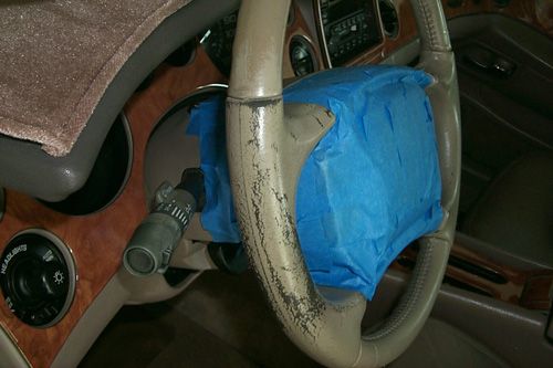

Thought I would share my recent experience refinishing the badly-worn steering wheel on my ’97 Riv. My approach was not to remove the steering wheel from the column to avoid dealing with air bag issues, and I found this to be satisfactory and met my expectations.

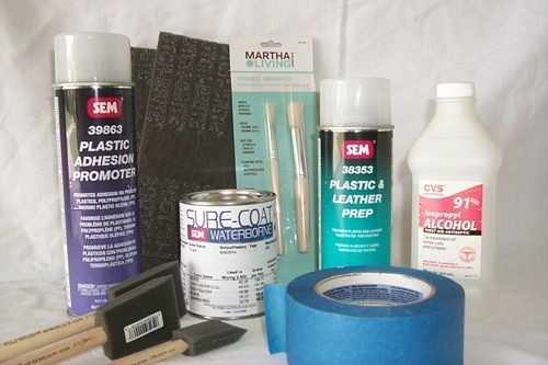

REQUIRED SUPPLIES & TOOLS:
NOTE: Be forewarned that the SEM supplies are excellent, but not cheap!
Preserving or refinishing painted vinyl steering wheel Supplies
SEM SURE-COAT Waterborne Paint ($52.10) – I had this paint custom-mixed for my interior by sending a scrap piece of my taupe (tan) leather seat to SEM for the “formula” and had it custom-mixed at a local auto paint shop. (If anyone needs the taupe formula, I will be glad to send it to you and save you the time and hassle.)
SEM PLASTIC & LEATHER PREP, 38353 ($13.49)
SEM PLASTIC ADHESION PROMOTER – 39863 ($25.54)
ISOPROPYL ALCOHOL 91%
GRAY SCUFF PADS
ASSORTED POLY SPONGE BRUSHES
3M PAINTER’S TAPE
STENCIL BRUSHES (Optional; probably not necessary)
LARGE DROP CLOTH
CLEAN LINT-FREE RAGS

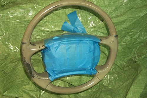

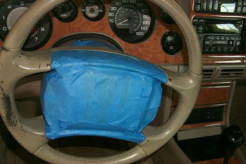

1. With 3M Painter’s Tape, tape-off the area of the steering wheel that you do not wish to refinish. In my case the center portion, including the Radio/Temp control buttons, was in fairly decent shape so I chose not to refinish this area and taped-off accordingly.
Preserving or refinishing painted vinyl steering wheel Tape_1
Preserving or refinishing painted vinyl steering wheel Tape_2

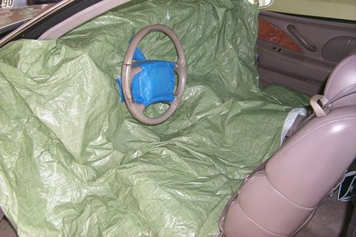

2. Place a large Drop Cloth behind and around the steering wheel, covering as much area as possible including the dashboard, center console and seats. Seal-off the steering column with 3M Painter’s Tape as well.

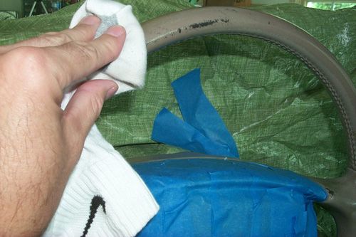

3. Thoroughly clean and wipe-down the steering wheel with Isopropyl Alcohol and a clean soft rag.
Preserving or refinishing painted vinyl steering wheel Clean_alcohol

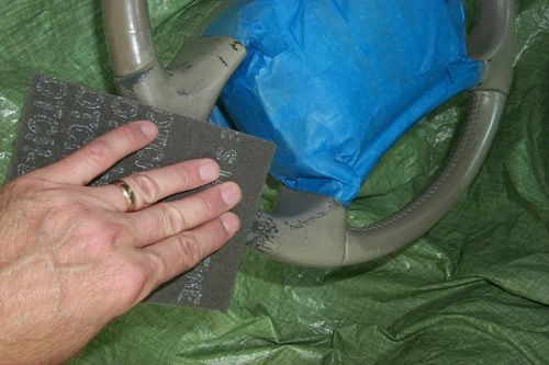

4. Lightly sand the wheel using a Gray Scuff-pad. Wipe with a clean rag.
Preserving or refinishing painted vinyl steering wheel Scuff_pad

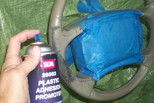

8. Spray a “light coat" of SEM 39863 Plastic Adhesion Promoter on the wheel and wait 5 minutes for the coat to dry.
Preserving or refinishing painted vinyl steering wheel Sem_adhesive
9. After the first coat is dry, spray again with a “wet coat" and allow 15 to 20 minutes for the coat to dry.
Preserving or refinishing painted vinyl steering wheel Adhesive_wet
