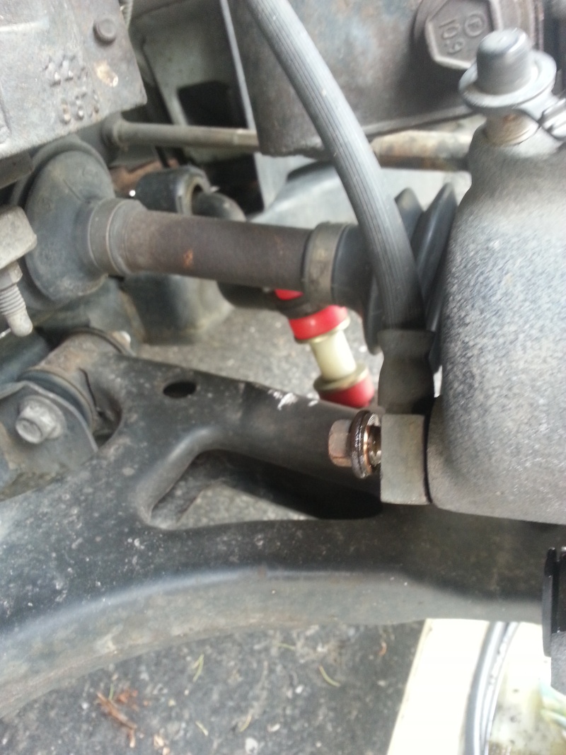

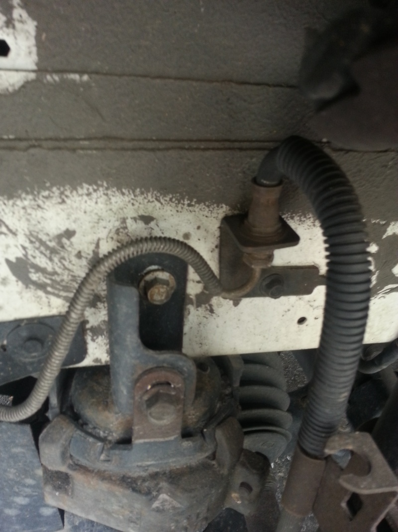

Stick your flat blade into the side of the bracket that holds the rubber line into the hard line and wiggle the bracket around until it pops off.
Should look like this when you have it off.
Remove the hard line from the soft line with a 14MM(?) wrench. Make sure that you have the catch pan underneath because fluid will come out.
Now you can remove the bracket holding the original line in place with a 10 or 11MM (I don't remember which).You won't be reusing it so you can just thread that bolt right back in without the bracket.
