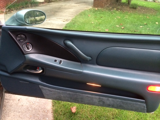

Following are some photos of the finished work.  I also installed the 1996 real wood (only year it was real wood from what I understand) shifter surround.
I think it turned out really well, and reminds me of the transition to the black instrument dash face Buick did in 1965.
Repainted dash and console black Photo_10
Repainted dash and console black Photo_11
Repainted dash and console black Photo_12
Repainted dash and console black Photo_13
Repainted dash and console black Photo_14

I removed all the pieces to paint them.  The "swooshes" are removable, but you have to be very careful because the plastic pins will easily break off when you try to remove the push on metal nuts, and often already are broken. I ended up with a stack of them from wrecking yards to cobble together two good ones.
Four years and about 50k miles later, the paint has held up completely and looks just as it did when I first painted it.
