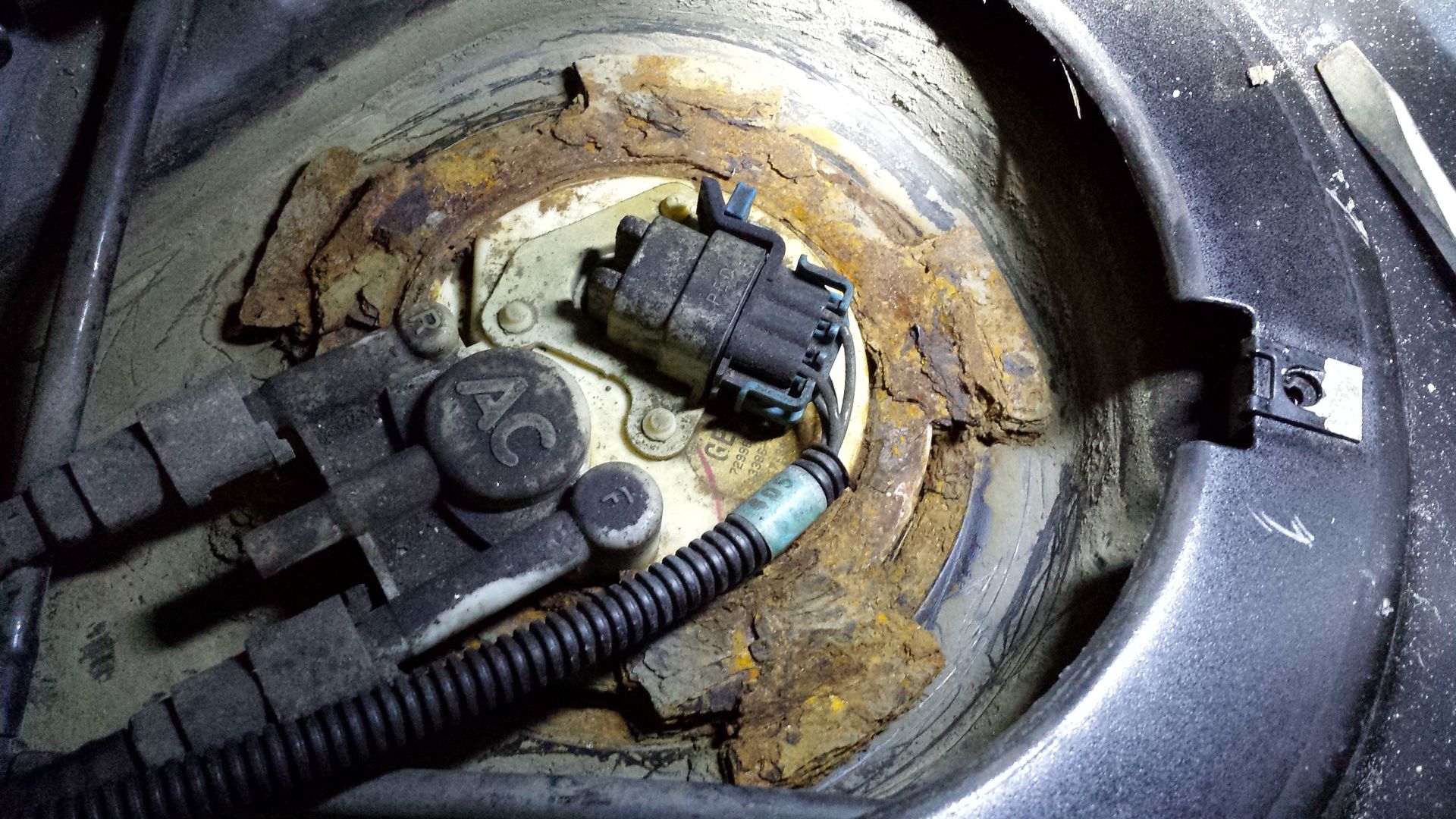

The P1133 has me a little puzzled. My O2 sensor is not old by any means. I believe it is about 3,000 miles old and a Denso. Still a possibility of it being bad, but I poked around the car, smelled gas by the right rear wheel, and opened the access panel in the trunk. After I cleaned up all the dirt I found this:
This is one of the worst I've seen. Could this be causing an EVAP vacuum leak, leading to my O2 problem? Is there anything supposed to be connected to that middle nipple? It smelled like gas pretty strong when I popped the panel off. My Aeroforce has been indicating to me for some time as well that my fuel trims swing wildly between +16.4 and -12.5 when the car is cold, and aren't much better when the car is warm.

From my experience, 99% of the time, a "Insufficient Switching" O2 code means that the O2 is bad, unless there is something causing it to set the code (refer to above). A leaky fuel tank won't set an O2 code. A leaking exhaust system will though.
As for the P1811....it could literally be anything inside the transmission, including a clogged filter or debris in the VB pressure circuit. The list is like 2 pages long. If the trans continues to shift more then .65 seconds between shifts, it will set the P1811. A failing or bad TPS sensor can cause this code as well, but you'd more than likely have TPS codes for that.
As for your Fuel Tank, I'm surprised it hasn't set an EVAP code yet. There really isn't any adverse driveability effects from it. The Pump is still going to pump fuel regardless of pressure inside the tank.

Once I saw how rusty the lock ring was on the tank, I was surprised I didn't see that kind of code either.
