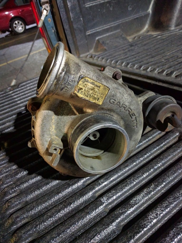

Made an impulse buy today...

A little info on the snail...
It's from a 7.3 Powerstroke, as far as I can tell somewhere between 94-99. I paid $100 for it and there is no play, so I'm pretty pumped.
It's ****ing huge. 1.10 A/R compressor, but I was lucky enough to get the .84 A/R turbine, so it will actually spool with the 3800 (some had 1.15 A/R turbines apparently).
This is copied from a Powerstroke forum.
STOCK GARRETT TP38 (on the 7.3)
Compressor wheel inducer diameter: 59.87 mm (60 mm)
Compressor wheel exducer diameter: 80 mm
Compressor housing A/R: 1.10
Turbine wheel inducer diameter: 76.2 mm
Turbine wheel exducer diameter: 69.84 mm (70 mm)
Turbine housing A/R: 1.15
The interesting thing is the turbo is reverse scroll. From what I understand, for my purposes all this means is the housings are mounted backwards.
This will be a slow moving project, but it should be fun.
