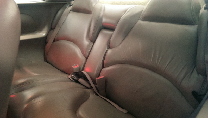

With my Miata in the shop for work of a forced induction nature and my '05 V6 Mustang being, well, an '05 V6 Mustang and refusing to allow fluids to be kept inside of it I needed something to work. As it would happen one of my coworkers was selling her "1998 Buick Riviera". Cool! I've always wanted a Riv, and a supercharged one to boot? Nice. I knew it was rough as hell but, hey, why not?
Well, it's a 97. Sad trombone, but the price was too good: $750, so it came home with me today. And here it is.

The good:
Interior is in great condition
Runs
Drives
World's lightest steering
Clean title
Fairly straight sheet metal
Cheap
Rides smoother than the '09 Cadillac DTS I was borrowing from work
Handles better than the Murdersofa even after the mods

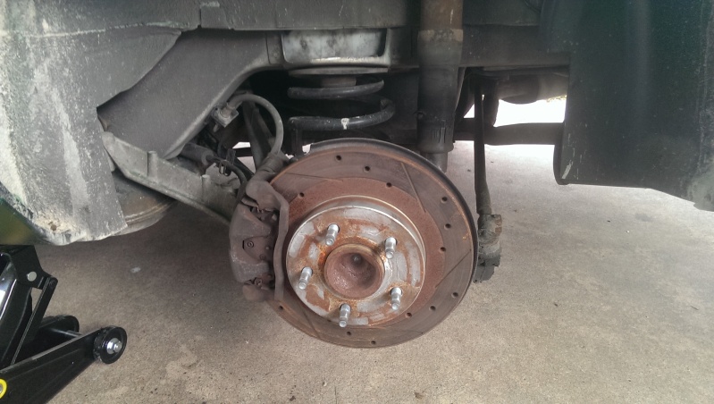

My '97 bucket. "I'd buy that for a dollar" Imag0220
Some brake rotors that hopefully aren't stupid amounts of warped

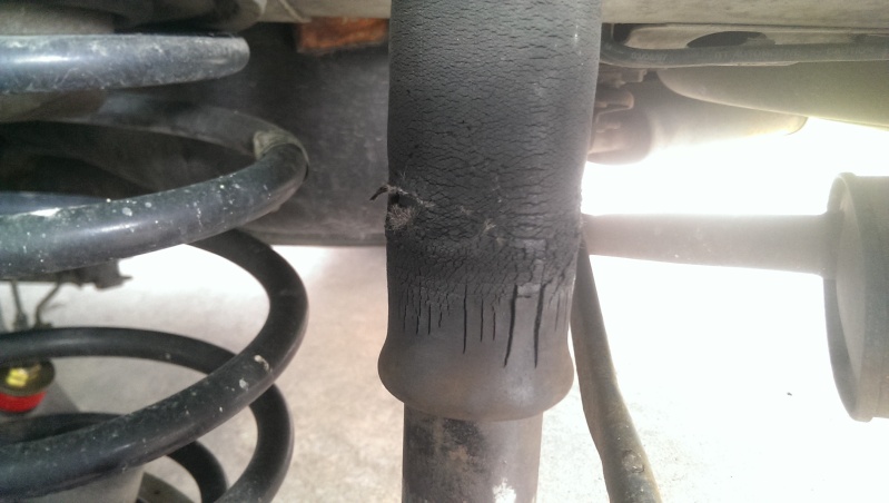

My '97 bucket. "I'd buy that for a dollar" Imag0221
Nope. DEFINITELY need new rear air struts.
Car drives much better now. Strong wheel centering, quicker turn in, less wallowy in corners. I'm very pleased with the results. Mildly annoyed that I need new suspension on all four corners, but having blown shocks will let me screw around with various spring combinations without worrying about ruining a set of shocks. Can't break what's already broken!
