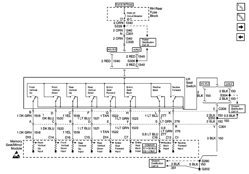

BAM!! Happy hunting
Driver's seat has a mind of its own... 1999_r11
