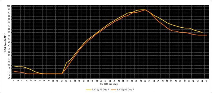

Last week I did a WOT at 85บF ambient temp. This week I did a near identical run at 75บF. Same location, same mods (3.4" SC pulley), same tune, same fuel (94 oct). Here are the results:
The 75บF (yellow) curve does spin out a tad at the launch, but notice it stays ahead of the 85บF (orange) curve the whole time, and starts to gain slightly up top. KR (not shown) was minimal for both runs. I plan to do more tests for 65บF and lower temps to show the effects of colder air on our engines. Also will compare 3.3", 3.2", and maybe 3.1" SC pulley if possible.

was IAT the same?
it will be nice to prove how air temps change our engines dramaticly...nobody believes me when i say it feels so slow when its 90* outside.

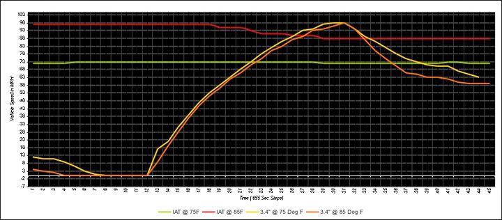

No, IAT was of course higher on the 85บF day. This is the reason for the performance increase.
Below is the same graph, but including IAT curves for the 85บF (red) and 75บF (green) ambient temps. My IAT sensor typically reads close to true ambient immediately after a WOT run, and according to the numbers, my 85บF day was actually 88บF. My 75บF day was actually 72บF. I try to take the car out when it's exactly the right temperature, but sometimes things can change by the time I get to "the track".

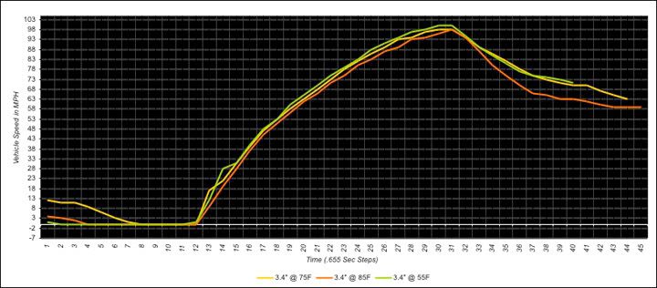

Here's a new graph with a 55บF run added:
The 55บF run is using a slightly different tune, but I think the results would be the same as it's close to the old tune at this point. I'm seeing the lower temps are making less of a difference now. Time to drop pulley size...

Today I did another WOT run at 60F with the 3.3" SC pulley. Interestingly, the result was EXACTLY the same as my run at 55F with the 3.4" pulley (green line above). I was very surprised at how close they were.
Just shows how much ambient temps can affect your times... just 5บF can make as much impact as a pulley swap!
