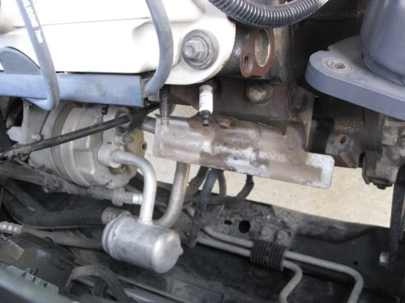

PostSubject: Plog clearance issue   Mon Oct 20, 2008 1:41 pm
This past weekend I swapped out my Plog and crossover, and reinstalled the oem crossover and my front PEM. Discovered a possible contributor to my increased KR levels with the Plog (besides NOT skewing the injectors).
When I installed the Plog, I left off the heat shields that were a real PITA to remove. However, I never removed a heat shield that resides just below the Plog-to-crossover connection, as it wasn't in the way, it seemed. But when I pulled the Plog on Saturday, I discovered an indentation on the lower/back side, caused by the head of that shield's attaching bolt. I also found carbon streaks on the lower edges of the Plog's flange mating surface, extending to the edge of the flange. So I had a slight exhaust leak, probably also pulling in some air, at all three tubes. This was not apparent with the engine running and hood open. No visual or audible clues about a leak.
Anyone else running a Plog find this happened to them also? If I had felt around the backside of the Plog, I'd have found this contact with the bolt. But it's not visible from above. I have not seen any mention of NEEDING to remove this particular heat shield on a Riv installation, and it's not in the way when removing the stock manifold. Anyway, I told Ben he'll need to remove the heat shield in that location, to avoid this same issue. I snapped a pic of the offending shield, will try to get it posted tonight. Might contact ZZP and mention this pitfall on the Riv installations.

I just checked and its getting a little dark but i felt where it came in contact with a shield , but i couldn't feel any indent with a bolt. Can you get a pic of where exactly the hole on your plog is?
PostSubject: Re: Plog!! (power log thread)   Mon Oct 20, 2008 9:46 pm
I'll post a pic shortly of the shield on the engine.
If you're standing looking down towards the Plog on your engine, the bolt head would be contacting the Plog on almost the exact opposite side from your angle of view. Like about a 135deg angle down and back from the top of the Plog.
PostSubject: Re: Plog!! (power log thread)   Mon Oct 20, 2008 9:57 pm
Ok, here it is. The offending bolt head would be the one just a hair to the right of the spark plug tip.

PostSubject: Re: Plog!! (power log thread)   Mon Oct 20, 2008 10:22 pm
Wow, thanks Dave. This pic really shows it. Now when I do the job, there's not going to be nearly as many surprises.
I just hope it's okay to remove all these heat shields, ya know?
PostSubject: Re: Plog!! (power log thread)   Mon Oct 20, 2008 10:45 pm
Hey, put them back on if you'd feel better that way. That coated Plog put out a lot less heat than the stock cast iron manifold did. Leave off that one offending shield though. Unless you want to increase that indentation before installation. Might be hard on the coating though.

PostSubject: Re: Plog!! (power log thread)   Tue Oct 21, 2008 11:47 am
If it's more thermally efficient than the cast piece, I suppose there should be no problem.
But seriously, why all these heat shields - what are they trying to shield the heat from?
PostSubject: Re: Plog!! (power log thread)   Tue Oct 21, 2008 1:25 pm
Not sure what all is in the vicinity... starter? A/C condensor? Dunno for sure. I'd have put them back on, but didn't really want to deal with ONE particular screw that's a real PITA.
PostSubject: Re: Plog!! (power log thread)   Tue Oct 21, 2008 1:26 pm
I should get them back on now, with the PEM back on. I messed around trying to position them last weekend, but couldn't quite figure out how they went back on. Anyone got a pic with the shields in place?
PostSubject: Re: Plog!! (power log thread)   Tue Oct 21, 2008 4:54 pm
The A/C compressor is right below the exhaust manifold. They are to keep heat away from the A/C lines and the engine block itself...
