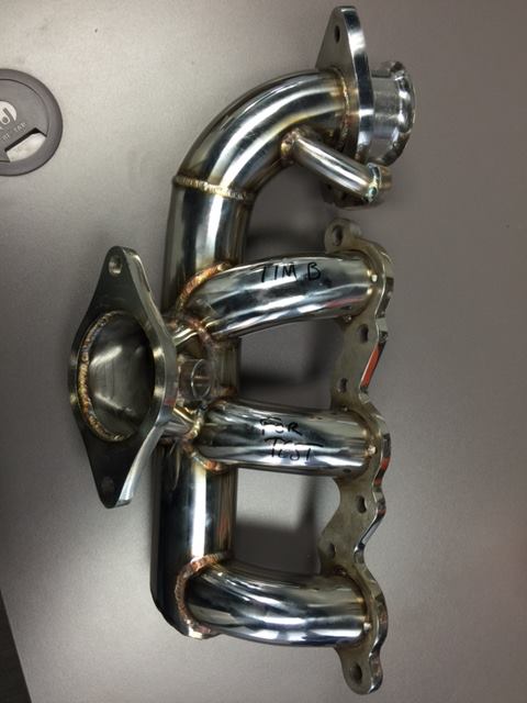

FYI - ZZP announced that they will be producing a rear PLOG, coming next year.
Post Count : 3912
PostSubject: Re: Plog!! (power log thread)   Wed Dec 03, 2014 9:15 am
Saw that on their Fbook page.
It's...........beautiful!

For the record, zzp newest rear powerlog will NOT fit the riviera, the h body cars according to zzp have an offset exhaust outlet. The rear plog was intended only for w body cars.
