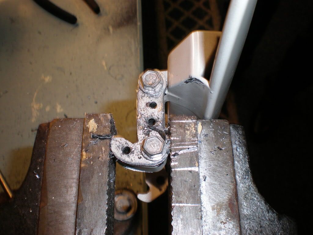

okay its been a minute since i havent post here.. but i have been checking out the site.. okay so my door hadle broke. i took of the door panel and took the the door assy..( thanks jimmyriv rock ) theres a little handle that s connected to the door handle... it goes down and opens the door when u pull the door handle.. that piece broke off... any ideas on with what can i glue it back on.. its not hard metal.. it seems its like made out of this plastic/metal material.. pls help!!

I would glue it with JB Weld. Those high strength expoxies don't seem to hold up to cold temperatures.

For parts like that that take lots of stress, I would not trust adhesives. Get a new or used replacement, imo.

Well here is what I did and I finally can open my door like a normal person....

yeahhh!!!! i glued on the piece that was broken with the JB weld.. and so far it worked pretty well!!! that stuff id gooooood!!!

I mad a bracket just to add extra strength. I was surprised how easy the door panel came off.
