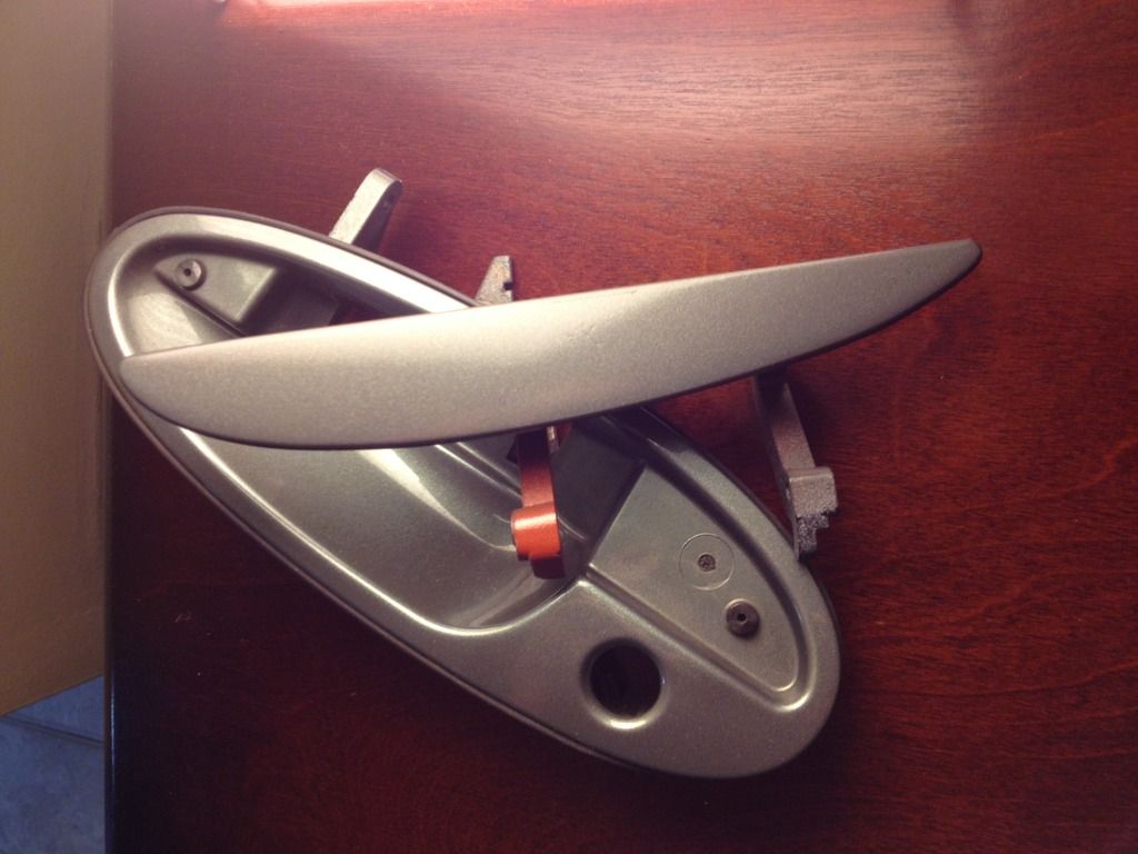

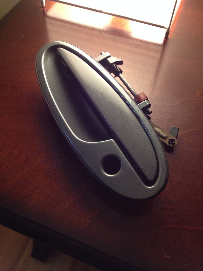

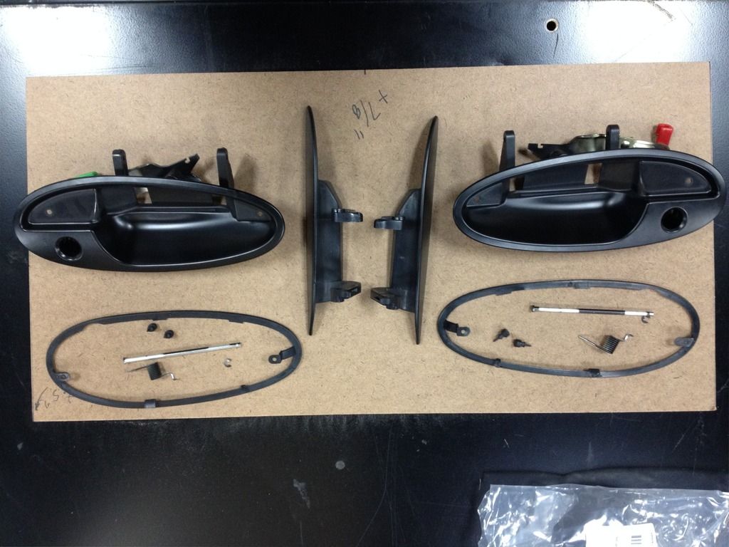

I went about fixing my broken handles (both left/right) by replacing them with this pair of replacements from AM Autoparts (eBay, $34.95 shipped):
http://stores.ebay.com/amautoparts/Door-Handles-Exterior-/_i.html?_fsub=11585825&_dmd=2&_nkw=Buick+Riviera
Here's what's included in the order:
A few years ago I replaced my wife's interior door handles (Toyota Corolla) and found they broke again after a couple years. Aftermarket replacement parts are hit/miss, and I don't care to replace my Riv's handles again in 2 years, so decided to modify accordingly.

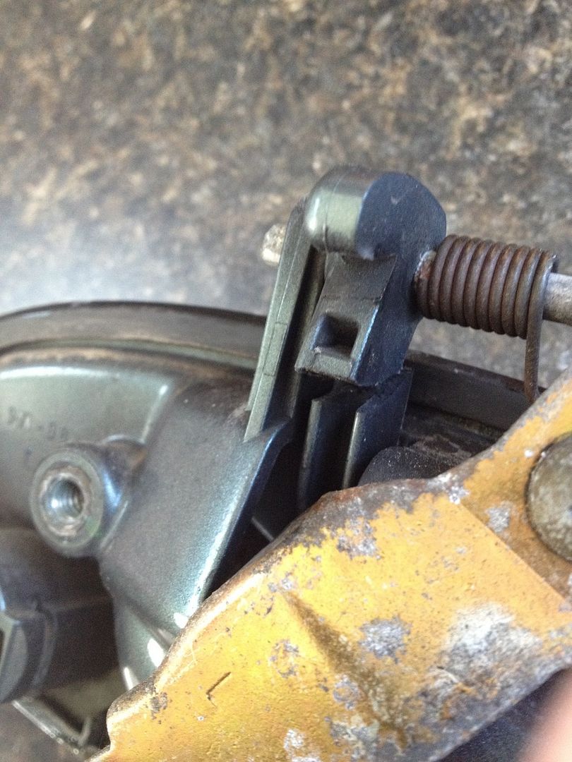

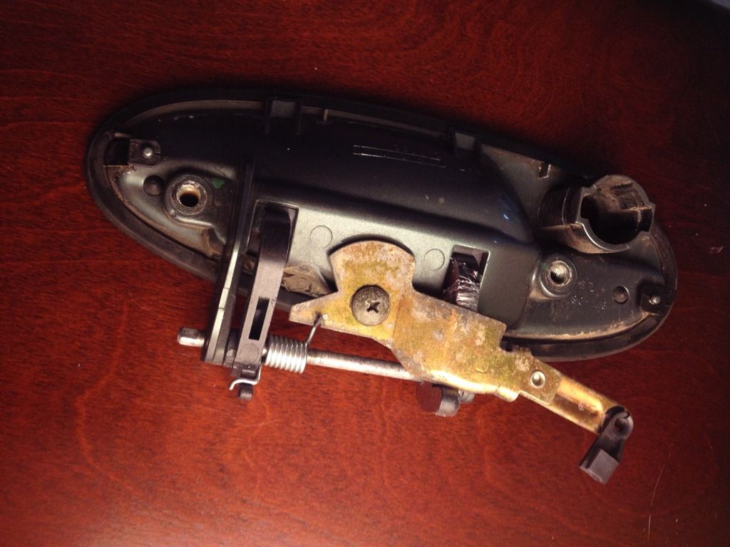

Both of my handles broke in the same location, like this (I realize this is different than some others'). Note how the arm broke right where the coring meets the solid portion. I believe the inside corners of the core creates stress risers, which contributes to the breaks:
The new aftermarkets eliminate the coring, so the solid arms should be stronger, but just in case I plan to add some strength.

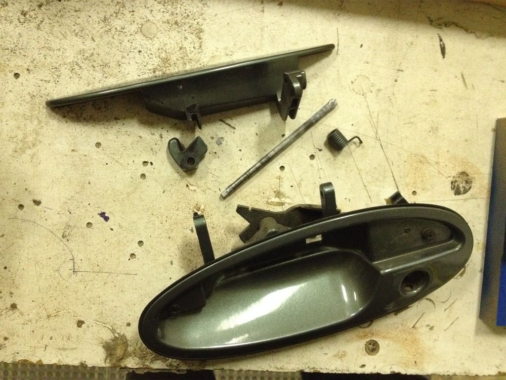

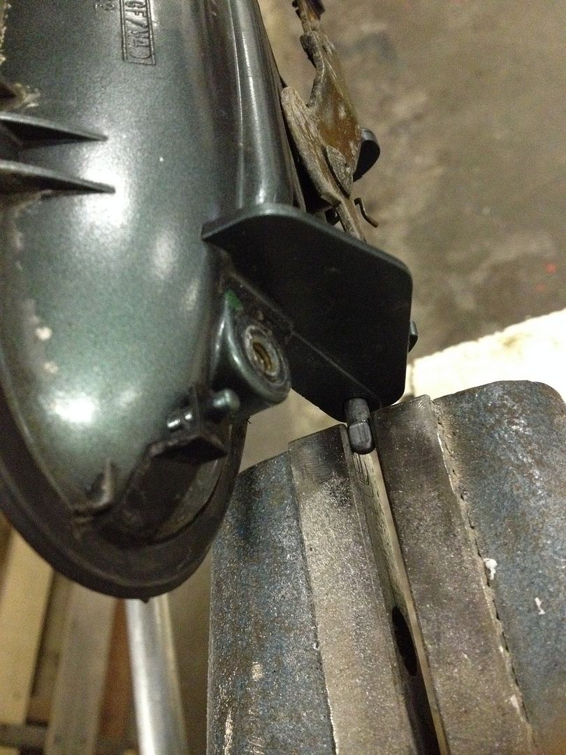

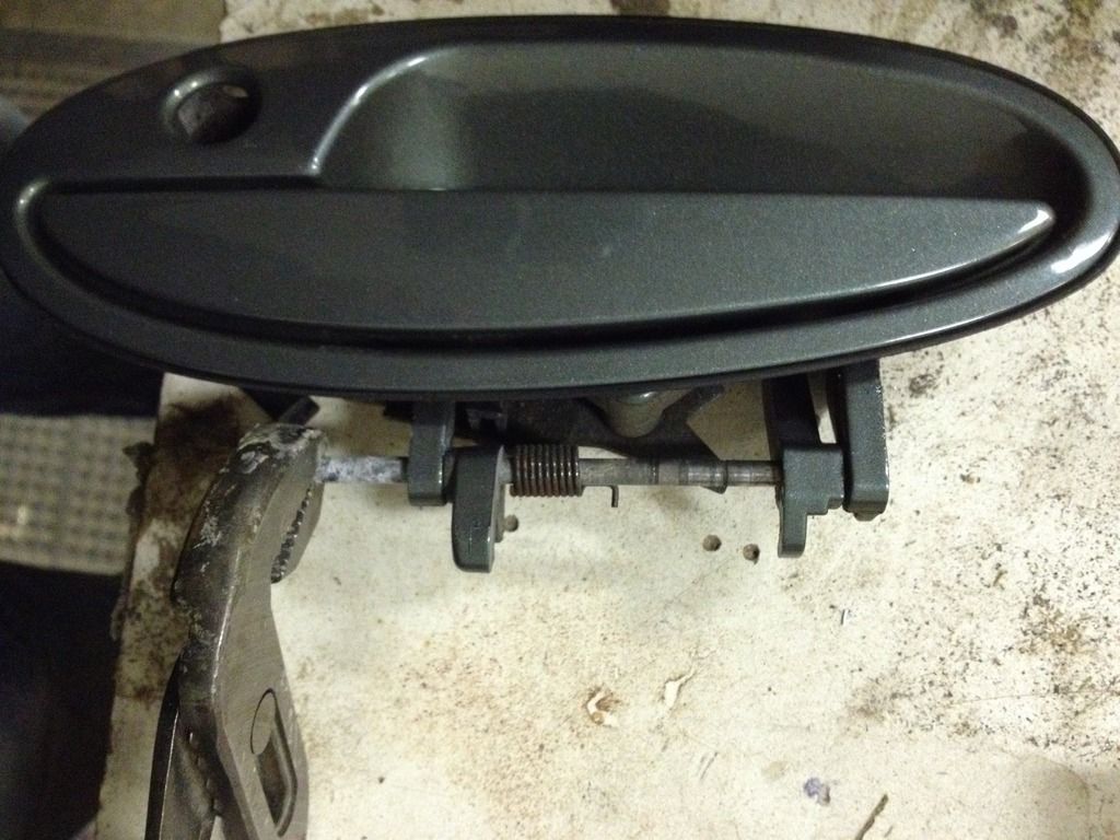

The OEM pivot rods are crimped on each end. To remove, I used a vise to "un-crimp" one end:
Pulling out the rod with pliers:
Disassembled:

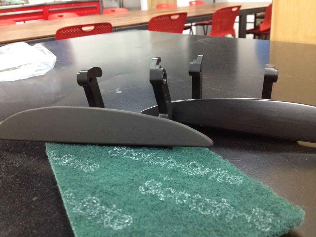

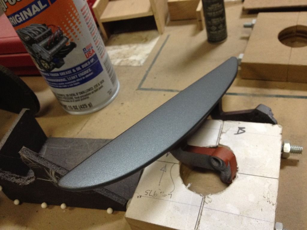

The handles needed paint. First used a scouring pad to rough up the plastic:
Then cleaned up:
Hit them with a few good coats of Rustolium plastic primer:
For paint, I dug up the bottle of slate green metallic lacquer from the body shop that painted my door a few years ago. ALWAYS ask for the extra paint when you get work done - you never know when you'll need it. Thinning the paint made it go a long way though the air brush:
After a few (thin) coats:
+ Duplicolor clear coat. I didn't paint the bezel, just used the OEM:

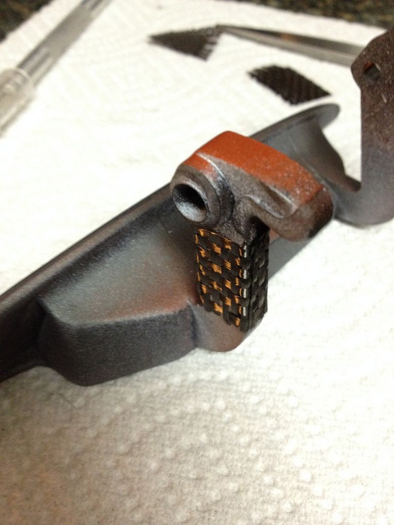

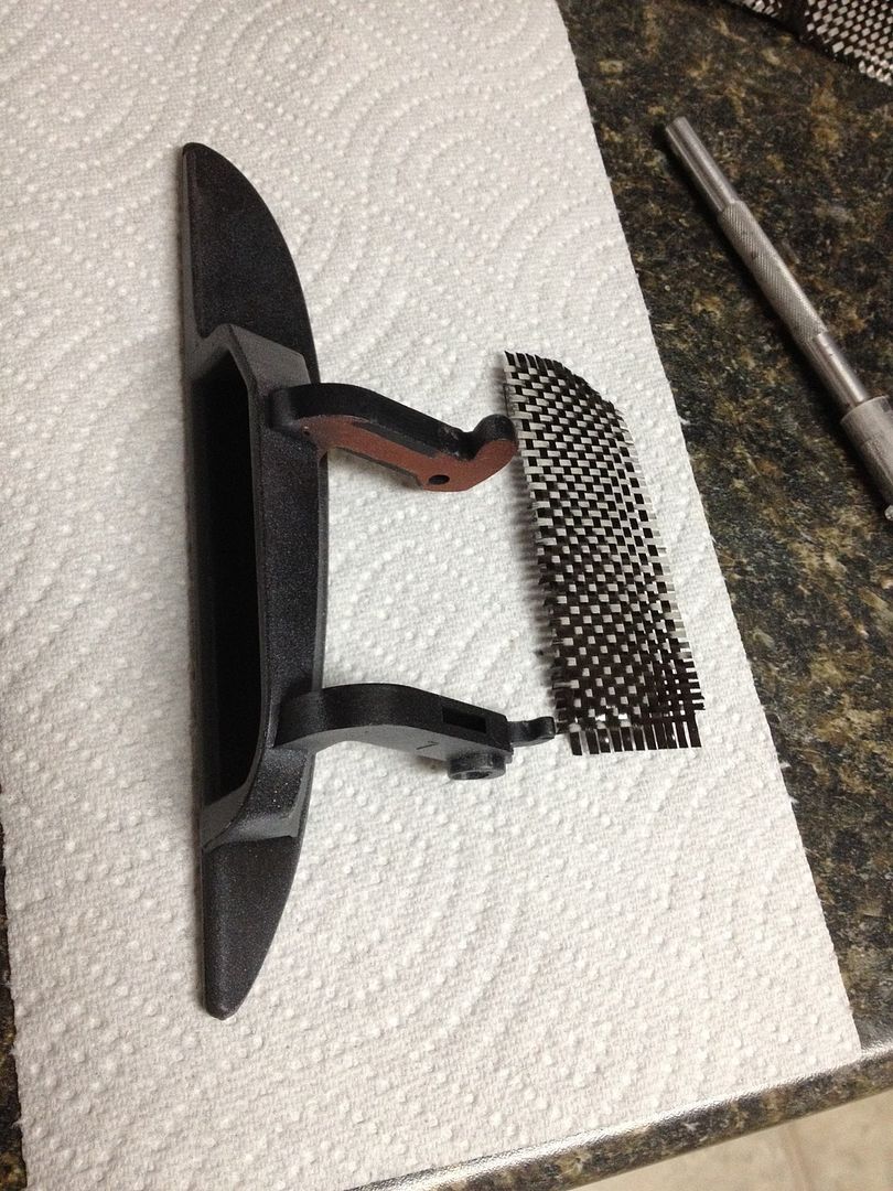

Now to strengthen the arm. I cut a small swatch of carbon fiber (normal weave) and sprayed one side with 3M Super 77 adhesive:
Then wrapped the swatch around the arm to create a splint in the area were the break occurred in the OEM handles:
I didn't photograph this part, but final step was to soak the carbon in 2-part, clear 5 min epoxy. Optional: I used a strip of plastic wrap to hold the splint as it cured. This makes for an incredibly strong arm that won't break. Understandably, the end of the arm near the pivot rod may fail - time will tell.
Here's the assembled handle ready for assembly:
NOTE: to use the new aftermarket handles with the OEM bezels, the holes on the handle arms must be enlarged slightly to fit the OEM rods. Just enlarge the holes with a drill bit - can't remember the exact size: .150" - .180" maybe.
