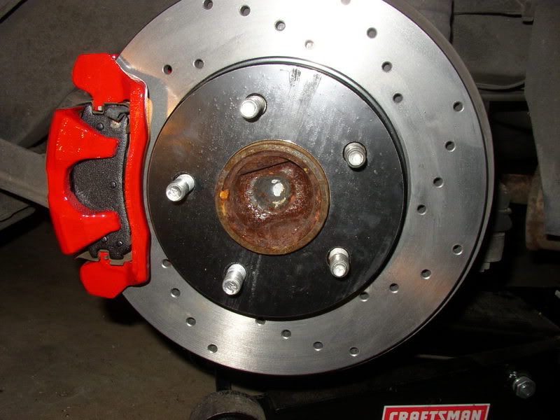

I used to use the cheap rotors from NAPA, Autozone, etc. but I had a lot of warping issues because of the way I drive. I bought a set of cross drilled rotors off of ebay and I haven't had those issues since. I think they really help to disburse the heat.

The fronts were too small, so they corrected it, but a conservative driver could get by on them. The rears however had a different kind of problem. Mine looked like this:
That's not rust, it's actually where the steel "plating" broke away. The insides looked to be made of sand. Talk about a nasty sound... I thought my rear wheels were going to fall off! Rear pads were totally trashed.
