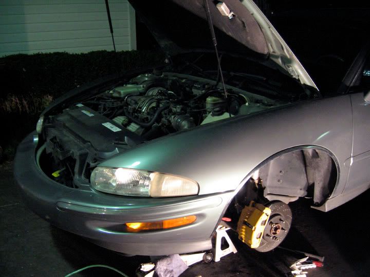

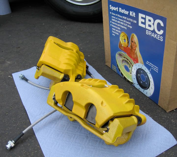

Ok, so Friday evening I finished assembling the new calipers. Greased the slide pins, threaded the bleeder valves, and attached the clips and pads. Here is everything ready to go:

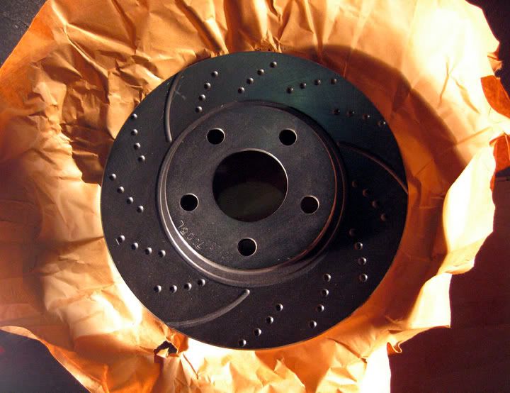

Here is an EBC GD Series rotor. It was nice of them to label L & R:

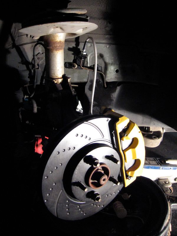

Picked up some DOT 4 fluid and gravity bled the driver-side line, making sure to keep the reservoir full. This required refilling about every 10 minutes. I did not push the pedal. Meantime, I fitted the new rotor and caliper, using the McMaster spacers:
Note from Admin: DO NOT USE THE BUSHING SPACER SLEEVES AS SHOWN IN THE CLUBGP WRITE-UP. THESE HAVE SHOWN TO WEAR AND CAUSE LOOSENING OF THE CALIPER. SOLUTION - HAVE YOUR F-BODY BRACKETS DRILLED AND TAPPED TO ACCEPT THE OEM BUICK CALIPER BOLTS.

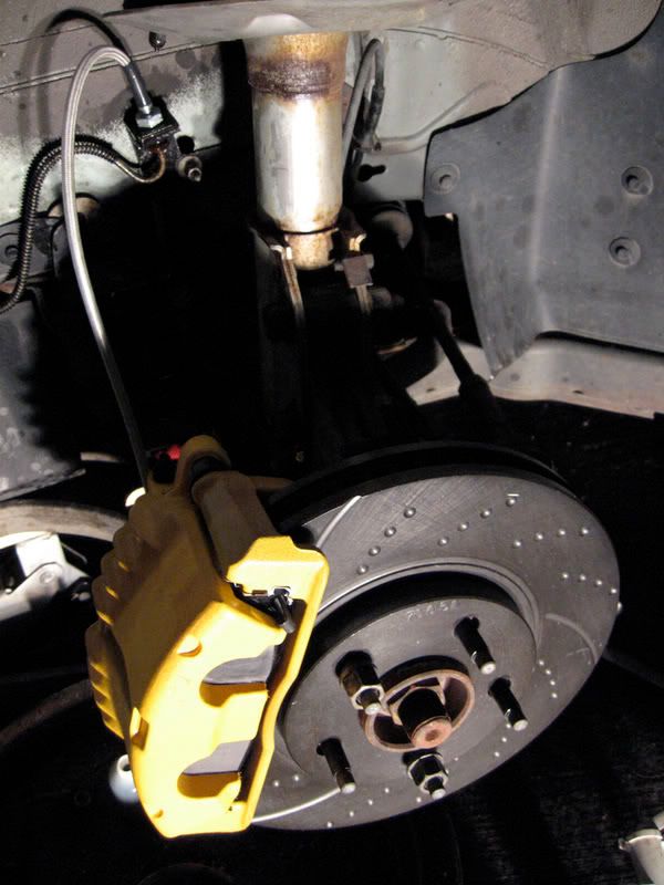

Used a vacuum pump to bleed air and old fluid out of the caliper, then gravity bled the passenger side, mounted the rotor/caliper, and repeated with vacuum pump. Here's the passenger side turned max left to check SS hoses:
Here's the driver side:
I tried to rotate the rotors by hand - this was very tough. Put the wheels back on, and drove out to bed-in the pads. Holy hell were these things loud! I thought I did something wrong... squealing and grinding, took several miles before they stopped making noise. Then I followed Hawk's bedding procedures, and things quieted down. I assume the calipers were sticking a bit, too - from being out of service for awhile. Once everything got hot and the pads bedded in, they started working right.

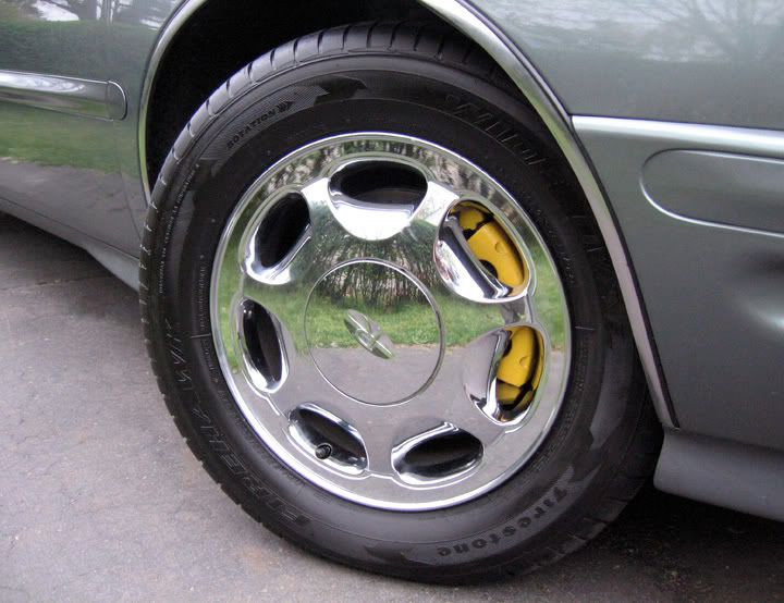

Here's a pic of the new set-up (after 250 miles):
