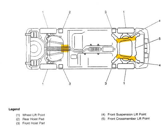

Here is a pic with the jack points clearly labelled:

Be careful with #3, it's VERY easy to get in the wrong spot.

those are lift points, not jack points. Jack points are on page 0-30 - 0-31 of the '98 FSM. they are listed as:
- under the front suspension crossmember, spanning at least 2 of the front suspension crossmember's rear reinforcement ribs, or optionally spanning both of the front suspension crossmember's front reinforcement ribs.
- never place the floor jack under the rear suspension crossmember's front reinforcement rib.
- under the rear suspension crossmember spanning both of the rear suspension crossmember's rear reinforcement ribs.
- there are also pads molded into the rear control arms shaped roughly to fit the cup that'a on a typical floor jack. These are on the front too but are on the wrong sides of the control arms - you'll get it when you crawul under to look
- in any event support the car after jacking with jack stands at the frame points earlier mentioned.

The areas in yellow are the only locations I will put jacks or stands under the car:
