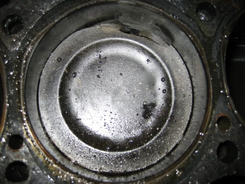

| - chitown_riv98 wrote:
- I'm starting to feel guilty for being cheap and getting 87 in the rivi. I'm going to BP and fill her up with premium right now.
You wont feel cheap when you have to drop $350 to $550 to have the heads milled and refurbished.Not to mention gaskets and labor.You'll feel like a big spender then! ( I speaking from experiencing ) | |
