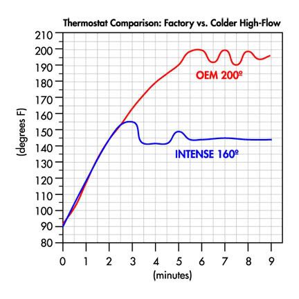

One concern when modding the L67 is how to rid the combustion chambers of excess heat. The easiest way to help lower engine block temps is to install a thermostat that opens at a lower temperature and flows more coolant than the stock unit.
Here is a graph showing two separate scans of my car, one with the stock thermostat and another with an INTENSE high-flow 160ºF unit installed. The tests were done on a 40ºF day over a span of less than 10 minutes, most of the time cruising at 65mph:
Should I replace my OEM thermostat? Tstatgraph
As you can see, the aftermarket 160º t-stat does its job quite well. After opening at 155ºF, the unit lets temps fall to as low as 140ºF, and it stays open after the engine completely warms up, keeping the engine at a sustained 145ºF operating temp at freeway speeds on a cool day. Note that 145º is much too cold for practical daily driving, and the 160º unit was removed after this test. But it shows its effectiveness.
In contrast, the factory (195º) unit lets the engine heat up to ~200ºF and then allows temps to fluctuate up and down within a tight 10 degree window as it opens and closes about once per minute. As far as I can tell, it does this continuously at freeway speeds, especially in colder weather.
Not exactly a ground-breaking study, but it's interesting to see how each t-stat operates. The end result is a considerable lowering of engine temps - an average of 50 degrees - a bit more than I had expected.
Caution: it has been determined that using a 160º t-stat can be dangerous for our engines in colder weather. The Riviera's PCM comes programmed with a setting called "KR activation temp". This setting is a specific engine coolant temperature value (158ºF), above which the engine's knock sensors will be activated and "listening for knock". Below this point, the sensors are ignored by the PCM, and the engine will likely knock (audibly) if pushed to WOT. For this reason, it would be unwise to run a 160º unit in ambient temps much cooler than 65ºF, as engine coolant temps will drop below the KR activation threshold.
Through the use of a PCM programmer like the DHP PowrTuner software, the KR activation temp can be set to a lower value (-40ºF) so that the knock sensors are "listening" at all times. However, it is suspected that running with an engine's coolant temps much lower than 180ºF can cause excessive engine wear over time, so it may not be a good idea to run a 160º except for racing applications. On the other hand, there are those who feel running cold is of not as much concern. Run the 160º t-stat at your own risk. A 180º unit is safer choice until it is known for sure how badly our engines wear at lower temperatures.
After this test, it was decided to use a 180ºF thermostat for the best balance of cooling performance, knock reduction, fuel economy, interior heating, and engine longevity.
