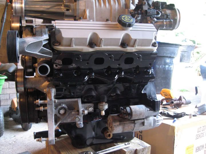

Post Count : 18335
PostSubject: Re: FAQ: What is spark knock? What is KR (knock retard)?   Sun Aug 03, 2014 5:27 pm
It isn't impossible to have 0 KR. I know the feeling - had a hard time getting any after I cleaned the fuel injectors. Try a run just past 2nd gear, so it shifts into 3rd and hold it for a sec or two. That's where you'll likely see it. Be safe - log and playback; don't monitor real time.
Plug in your scanner, turn the car "on", not running. Start your scan. Take a hammer and tap the block near the knock sensors. You should see some slight blips.
If you're actually knocking, you can hear the knock. It's a slight "ting, ti-ting, ting" sound under boost.
I've never heard of a code being thrown for a bad KR sensor, nor have I heard of a sensor going bad.
Age : 22
Post Count : 2678
Merit : 49
PostSubject: Re: FAQ: What is spark knock? What is KR (knock retard)?   Sun Aug 03, 2014 7:35 pm
I like this option. Where are the sensors at?
Post Count : 18335
PostSubject: Re: FAQ: What is spark knock? What is KR (knock retard)?   Sun Aug 03, 2014 7:45 pm
Low middle of each side of the engine, nearest to cyls 3 and 4. One sensor in front, one in back.
You can see one near the starter in this pic:
