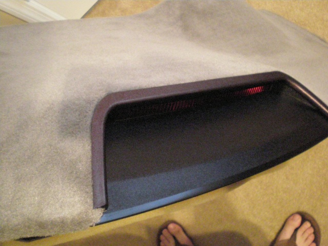

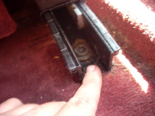

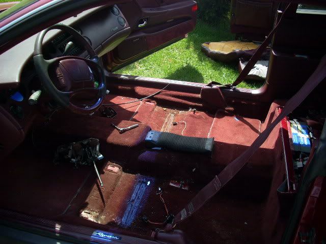

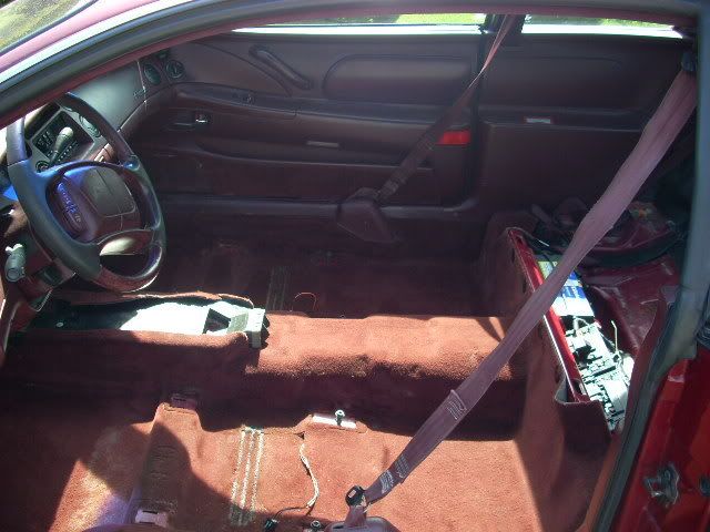

| om so you have decided to remove the seats from your riviera. Great its not to hard at all. First lets do the back seats because there easy. Step 1 :pull up on the edge of the bottom back seat, it should pull right up, then it will come right off. Step 2: to remove the back seat you will need a 19mm socket in 1/2" drive. . they should come right out. Step 3 : Now pull out at the bottom of the seat and push up the seat should come right off. then ur done the back seats are out. TO REMOVE THE FRONT SEATS Step 1: put both seats up as far as they will go. Step 2: get a 15mm socket 1/2" drive Step 3: now there is 2 bolts, on the back side of the seats that need to come out. Step 4: After them bolts are out, you need to push the seat up and unhook the wiring connection. now after that is unhooked. push the seat up and try to lift it out, it should roll out of the groove. and ur front seat is out. . now just clean up the floor the best you can. and ur done and can ahve the clean carpet the best part is when you find a $1.93 in change on the floor, yes 1 drop of gas | |

| nice! looks like i have a new way to clean my interior i have a few pics of the rear seat and top deck removed. cant have too many pics right? this is the tab on the back of the bottom seat (rear). this along with he front clip you pull up on are the only things holing it in place. (3 front clips, and 2 back tabs) these are the metal brackets holding the upper part of the seat backing in place. lift up to remove it after taking out the 2 19mm bolts. ( 3 metal brackets) the back deck pulls out after unhooking the seat belts and 3, IIRC, plastic push tabs. be careful, the foam they use doesnt handle much abuse. it is a PITA to take out btw. most of the wires are for my subs. the whole reason i remove all of that was to paint the grey trim around the 3rd brake light so it wouldnt stick out around the window tint so much. well come to find out, it cant be removed from the deck to be painted. so i used a sharpie lasted so far, but i'm sure it will fade in a year or so. here is everything you need to clean the leather. 1 bar of moisturizing soap (very mild) i used dove. a soft sponge. a towel to dry, and some water. first vacuume the leather and wipre it down to remove as much grit as you can so it doesnt scar up the seats. then lather up the soap and water on the sponge and scrub the leather to clean it. clean off all the soap residue, but dont use too much water.(spray bottle works well) lastly recondition the leather. i used gold class liquid leather conditioner(no picuted) sorry i didnt mean to hijack your write up with my quick guide to cleaneing the seats _________________ 1996 with 254k miles, L32Â 4" FWI -> ported N* -> Ported Gen V w/3.0" Pulley, Stage 3 Phenolic I/C, ZZP FMHE, 1.84 RR, Headers and 3" pipe to mufflers, F-body brakes, and lowered on Eibachs. -RIP AMG C400 White on black. Stage 2 w/E30 - 11.9@117 -daily | |

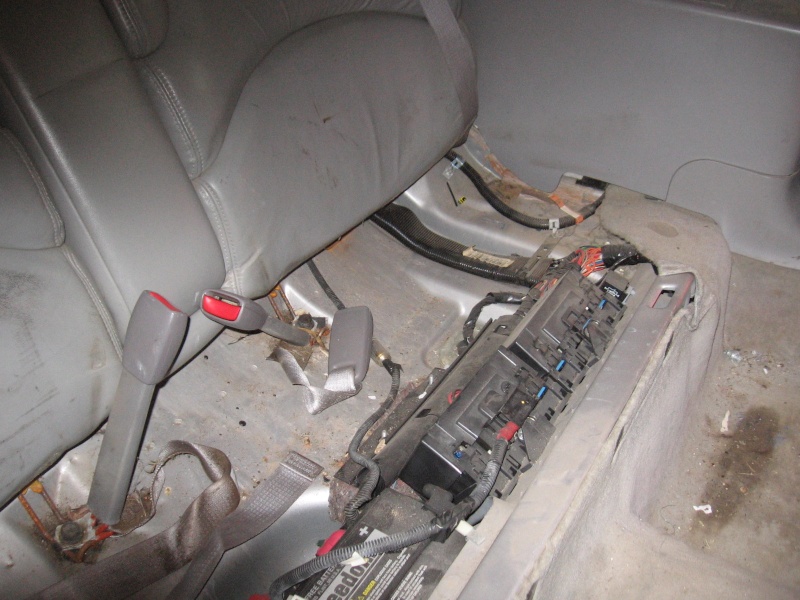

| Here is the pic of underneath the rear seat which one would it be This is from my car: | |

| the breakers of interest are in the lower right corner of the fuse panel closest to the center hump (where the exhaust resonator and exhaust pipe run under floor of car). The fuse panels have plastic covers that lift off once you work the clips that hold them on. It's all pretty obvious when you look at it. So to find them you pull the rear seat bolster (it lifts out no tools push in toward trunk on the lower edge you'll feel the wire, it hangs on a clip stamped into the body pan, then lift seat like a car hood, reinstall is reverse of removal) and look on the right side, there's 2 plastic boxes, they are the fuse panels, they are covered. You have to take the cover off to get to the fuses and thermal breakers.
To work the clips off one way is to use a small screwdriver to hold the little metal clips away from the covers, then slide the covers off the fuseblock bases. You will have to wiggle them around to get them off they are not a loose fit.
By the way that battery is probably original to the car and you should consider testing it. By now it almost certainly needs to be replaced. Low voltage on that battery will cause all sorts of anomalous problems. The GM dealers and many other battery dealers now sell a somewhat physically smaller battery so if you get one there also be sure to get the matching vent assembly. If you do not, the acid fumes will rot the floor away very, very quickly.
