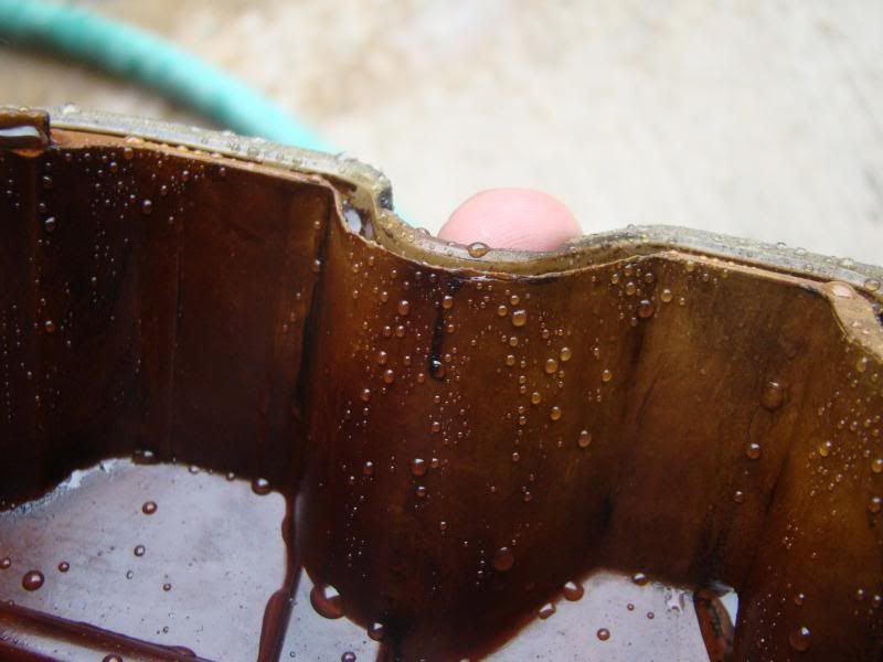

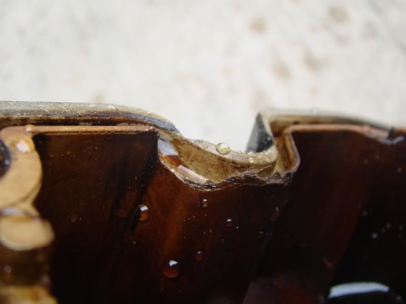

Thanks Scott. I haven't messed with the valve cover for years but I got it off a little while ago, inspected the underside and found that one of the areas that curves around an injector was cracked and a chunk of the valve cover material fell off when I touched it...
As compared to the other side which is totally intact... only has one small hairline crack in it:
Does anyone think the chunk missing would affect the gasket seal, performance, pressure, oil leakage, etc.? I'm prepped to put in a new gasket and new screw grommets

PostSubject: Re: Valve cover gasket replacement - advice?   Sun Aug 18, 2013 2:47 pm
I think it needs replaced. That's just asking for a leak right there. Good opportunity to clean up or paint a fresh set of covers!
Joined : 2007-12-24
Post Count : 498
PostSubject: Re: Valve cover gasket replacement - advice?   Sun Aug 18, 2013 6:19 pm
Okay thanks AA thumbsup Sometimes I just need that second Riv owner opinion. The reason I took the front cover off is because it was leaking and that missing chunk probably had something to do with it.
