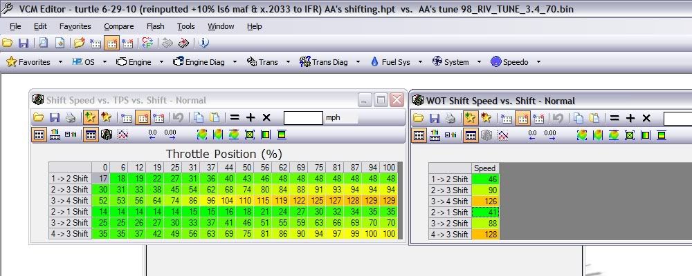

AA, I randomly came across something that looks strange to me.
Is that how you have yours now with the WOT upshift speeds being less than the end of the normal upshift speeds? I'm sure the PCM is making its own sense out of that but was that a mistake or is there a reason you did it that way?
Post Count : 18332
PostSubject: Re: Shift Points   Mon Aug 16, 2010 9:55 am
Preface: in my WOT shift table, my 1-2 shift value is 48, not 46. Not a big deal, just pointing it out.
But you are correct, the other values are lower than the max throttle position values. There is a reason for it. You need to consider RPM when upshifting at WOT.
At throttle positions less than 100% (not WOT) the PCM uses the throttle position table, and upshifts based on MPH only. It does not consider the RPM.
But when the PCM upshifts at WOT, it checks two things: RPM & MPH. There is a 1-2 shift RPM value. It will only shift when both values are satisfied. So, if 1-2 shift is set to 5700 RPM, the PCM will upshift only at or above 5700 RPM, and only when the desired shift speed is met (48 mph). If the desired shift speed were higher, say 55 MPH, it is quite possible to exceed 5700 RPM until the car is moving 55 MPH. If your redline is set to 6kRPM, you may bump it - result is a fuel cut, similar to top speed governor.
The reason my MPH is set low for WOT upshifts is because I want those shifts to be determined solely by RPM, not vehicle speed. 48 MPH is low enough that I will always be going faster at the 1-2 shift, so I get a 5700 RPM shift every time. No worries about over-revving, not fuel cut.
It does seems strange in your tables, but you aren't showing the RPM table. In that context, it makes better sense. Hope this helps.

PostSubject: Re: Shift Points   Mon Aug 16, 2010 4:35 pm
My table has shift times set at .01 secs for all. I assume Scott used this value if he copied my tune.

Yes, except for the TCC lock-up values, which have been completely disabled. See link for details:
http://rivperformance.editboard.com/t8717-write-up-tuning-trick-for-failing-torque-converter-clutch-tcc-lock-up
I've driven almost 80k miles after shutting down the TCC solenoid. Other than the impact to MPG (a significant one), there are no ill effects. In fact, throttle response in 3rd and 4th gears are superb with no TCC (must install big trans cooler). However, with a working TCC, using the values in this thread would be the optimum set-up. If I ever pull my trans to rebuild again, I'll switch back to the TCC tune above.
As for the shift time values, yes you should use .01 ms - because the shift time values are not literally the times your trans will shift at, a "goal", and not the limiting factor in the grand scheme of things. Fluid pressure and TM values keep the trans shifting more slowly (50 ms is a "fast" shift). Only increase shift time values if you desire a longer shift time than what you're currently seeing.
