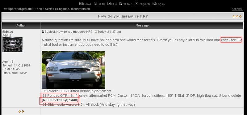

PostSubject: How do you measure KR?   Wed Sep 24, 2008 2:37 am
A dumb question I'm sure, but I have no idea how one would monitor this. I know you all say a lot "Do this mod and check for KR" - what tool or instrument do you need to do this?

lol, we never checked knock on it but for the record it was not and never was my car. His first mod was the 3.4" pulley (Yeah, that was smart...rolleyes).
