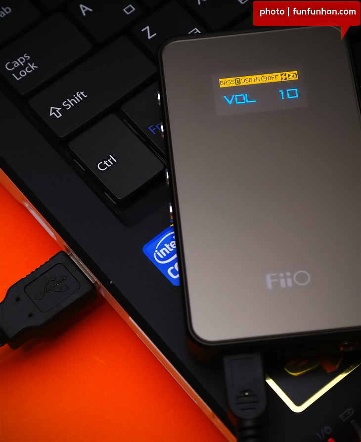

Aaron, if you are interested later, in improving the DAC output from your iPhone if you ever decide to use with studio headphones, or better yet, want to maximize quality from your stock stereo:
http://www.amazon.com/FiiO-Portable-Headphone-Amplifier-Black/dp/B003N0XDT4/ref=sr_1_1?s=electronics&ie=UTF8&qid=1342629165&sr=1-1&keywords=fiio+e7
http://fiio.com.cn/product/index.aspx?ID=28&MenuID=020301
Subwoofers, Speakers & Amps - Page 18 1572F3194CBED9361EE0B9
These specs are extremely impressive for a portable USB DAC headphone amp combo, especially at that price.
http://www.amazon.com/FiiO-L7-Line-Dock-Cable/dp/B004QVNS0S
Line output dock for the E7/E17. This would give you the best possible quality for the price, in my opinion, and would make your iPhone probably sound better than the CD deck of your stock head unit, with a DAC that nice.
Just something to keep in mind, I plan on actually get one eventually for my studio cans smile

Thanks, I'll look into it. I've had a pretty good set-up since I installed my system 8 years ago. Sounded good then, still does now. Guess I will need to upgrade at some point, but at the moment I'm enjoying the seranade of a newly rebuilt engine.

No problem. And, you'd be surprised at what simply a better DAC and line out to a superior analogue setup can do. I never even realized how extreme the difference was until I started using high quality headphone amps. They make my headphones that suck on an iphone, some of the best sounding headphones Iv'e heard, and because of this, the set of cans actually got a terrible review, not deserved.
I'm not joking by the way. My headphones on my headphone amp have better imaging than my analogue surround sound out to 5" kevlar 0.05% THD bi amplified 1" Silk dome studio monitors with the Velodyne ULD 18 subwoofer (best sub I ever heard yet, when it worked right), even though the highs are ever so slightly recessed, all of the imaging is present with a good headphone amp. On a good FLAC file, I can basically hear it as if I were in the studio as they recorded it (I know what this feels like, I interned at a recording studio for 3 months).
