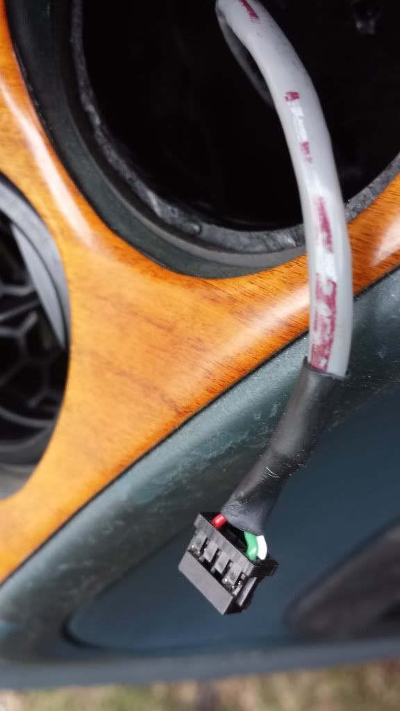

Is this the 3 wire
who has hooked up this correctly
Has anyone bought this with this many wires and it works?

Cause it does not come on or off with the car I already done that I hooked it up every way possible and it does not work

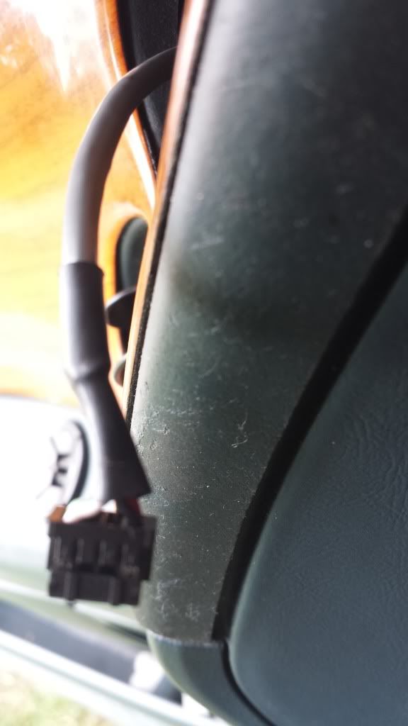

 even then looking at that still dont tell me nothing Aa mines dont even look like that at all.. if you refer back to the page before you can see the pictures ive posted
Aeroforce tech emailed me back;they said the plugs that I was given was given was wrong. I should have the 3 wire shown in your manual and zzp didnt sell me that standard they took it out of my box
