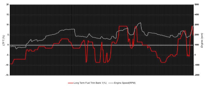

Post Count : 18332
PostSubject: Re: AA's DHP PowrTuner log   Tue Apr 10, 2007 9:11 pm
Tune #9:
After adjusting the IFRs, I rescanned and tuned once more. The results are pretty impressive. I haven't even touched MAFF values yet, and my LTFT values are vastly improved in the idle and cruise ranges. Here's what my LTFT looked like 3 days ago:
You can see how the red line (old LTFT) is all over the place, never at zero. This means the PCM was adding fuel when above the line, trimming fuel when below. These are pretty extreme considering I hardly went over 3k RPM.
Below is a scan after the tune. The green line (new LTFT) is almost always at or near zero, even though I was having a lot more fun with the throttle:
The graph shows that trims are much more stable, meaning the PCM is more in control of the fuel delivery. Now I just have to figure out how to tune for WOT and get rid of that KR. More to come, stay tuned...
