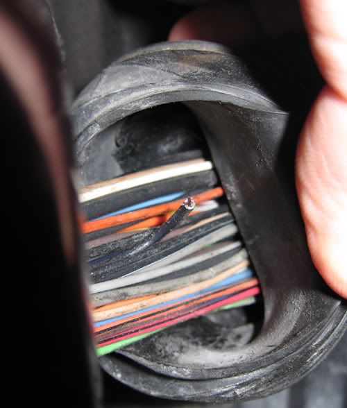

PostSubject: Window Problems   Fri Apr 08, 2011 1:09 pm
Ok guys this started about a week ago. I rolled the passenger window all the way down and it wouldnt go back up,using either switch. So i then went and bought a used passenger side switch which they tested. I then took apart the door panel and just hooked up the newer switch. The window stil wouldnt work but i could hear a clicking noise from the motor when I pushed down on the passenger switch. I also plugged in the old switch and it did the same thing. So the switch wasnt my problem.
So I took the motor out and made the window go up manually, so i caould drive it. I then bought a used motor which also was tested and it went up and down when tested. I then installed the newer motor and now when i use the passenger switch the window will go down not up. But when I use the drivers switch the passenger window doesnt do anything. So now I am thinking that maybe the drivers switch is bad. My drivers window goes up and down fine.
So conclusion is that the passenger switch will make the window go down not up and unlock the doors. The drivers side switch wil unlock doors, roll the drivers window up and down but it wont do anything with the passenger widow.
Has anyone else expierienced something like this. Should i try replacing the whole drivers side switch and see if that fixes. Could the drivers switch really cause all of that to happpen.

PostSubject: Re: FAQ: Power Window Problems   Fri Apr 08, 2011 1:49 pm
This is a mystery.
...i know this will sound like a PITA but do you think you might use a 12v continuity light or meter and recheck switchess, the motor and wiring while it's hooked up? If you need more on how to tel if the voltage readings are off o r whatever please repost. The light will confirm that the switches are passing power. The meter will tell you for instance, if the switches or wiring has developed high resisitance for some reason.
At the same time do you think you might recheck your window regulators, maybe something froze and got bent over the winter, so you could move it manually but the gears are stuck? or maybe the lube has dried to the point that it is gummy (seeing that at times). I suspect this is not a problem though.
What else do you think might be wrong?

PostSubject: Re: FAQ: Power Window Problems   Fri Apr 08, 2011 1:54 pm
I'd be checking the wires in the rubber pass through. Sounds like you may have one that's broken.

PostSubject: Re: FAQ: Power Window Problems   Fri Apr 08, 2011 1:58 pm
Bam you get the prize again Abaddon... this makes a lot of sense, the rubber strain relief link is a known problem area and wires broke that way inside it might well act different door open versus door closed.
PostSubject: Re: FAQ: Power Window Problems   Fri Apr 08, 2011 5:58 pm
Yup, this is what I found on the driver side...
Just pull back the boot on both side and see what shows.

PostSubject: Re: FAQ: Power Window Problems   Sat Apr 09, 2011 1:22 am
Cmon now.....we still don't know if neb's car has a broken wire yet! BMD just posted a pic of what he found to show neb what to look for......but thanks? oops

PostSubject: Re: FAQ: Power Window Problems   Mon Apr 18, 2011 1:42 am
Ok well the problem ended up being a broken wire on the drivers side. Nothing wrong with either window swithes or either motors. It is crazy how the drivers side can cause the passenger window to only go down and not up.
The broken wire may have been caused when putting the new doors in who knows. But it is fixed now. Theo nly other problem I am having now is the mirror do not work. They were tooken apart for painting. The mirror makes the sound like it is moving but it doesnt. My guestimate would be something internally on both of them. So i will take them apart sometime. Any other suggestions?
