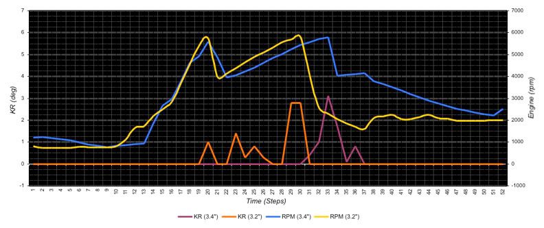

| Here's a couple graphs comparing the 3.2" and 3.4". In the first graph (RPM vs. KR) the 3.2" shows more frequent knock, but it's below 3º and fairly short-lived (not severe, imo): The resulting performance increase (Throttle % vs. MPH from the same run) is impressive: _________________ '05 GTO 6.0L • 6-spd • 95k miles • 0-60: 4.8s • 16.9 avg MPG • Nelson Ledges Lap: 1:26'95 Celica GT 2.2L • 5-spd • 165k miles • 0-60: yes'98 SC Riviera • 281k miles • 298 HP/370 TQ • 0-60: 5.79s • ET: 13.97 @ 99.28 • 4087 lb • 20.1 avg MPG • Nelson Ledges Lap: 1:30 3.4" pulley • AL104 plugs • 180º t-stat • FWI w/K&N • 1.9:1 rockers • OR pushrods • LS6 valve springs • SLP headers • ZZP fuel rails KYB GR2 struts • MaxAir shocks • Addco sway bars • UMI bushings • GM STB • Enkei 18" EV5s w/ Dunlop DZ101s • F-body calipers EBC bluestuff/Hawk HP plus • SS lines • Brembo slotted discs • DHP tuned • Aeroforce • Hidden Hitch^^^ SOLD ^^^ '70 Ninety-Eight Holiday Coupe 455cid • 116k miles^^^ SOLD ^^^ | |

| Subject: Re: AA's DHP PowrTuner log Mon Apr 16, 2007 7:09 am | |
| Well you answered my question over here . Looks like the 3.2 isn't much more kr than the 3.4? | |
| Subject: Re: AA's DHP PowrTuner log Mon Apr 16, 2007 8:27 am | |
| In this case it looks that way, but not really. the 3.4" run was without much of a tune (didn't need it until up high, really). The 3.2" took some dailing in. Before the tune I was running near stock MAFF values. KR popped up earlier, and sustained in the 3-5º range. I got a nasty peak of 6º last year at the track. Now it's under control it seems, at least at 40ºF, but no, we are not comparing apples to apples in terms of KR. I'll try to find a previous scan of the 3.2" so you can see how it was. _________________ '05 GTO 6.0L • 6-spd • 95k miles • 0-60: 4.8s • 16.9 avg MPG • Nelson Ledges Lap: 1:26'95 Celica GT 2.2L • 5-spd • 165k miles • 0-60: yes'98 SC Riviera • 281k miles • 298 HP/370 TQ • 0-60: 5.79s • ET: 13.97 @ 99.28 • 4087 lb • 20.1 avg MPG • Nelson Ledges Lap: 1:30 3.4" pulley • AL104 plugs • 180º t-stat • FWI w/K&N • 1.9:1 rockers • OR pushrods • LS6 valve springs • SLP headers • ZZP fuel rails KYB GR2 struts • MaxAir shocks • Addco sway bars • UMI bushings • GM STB • Enkei 18" EV5s w/ Dunlop DZ101s • F-body calipers EBC bluestuff/Hawk HP plus • SS lines • Brembo slotted discs • DHP tuned • Aeroforce • Hidden Hitch^^^ SOLD ^^^ '70 Ninety-Eight Holiday Coupe 455cid • 116k miles^^^ SOLD ^^^ | |
| Subject: Re: AA's DHP PowrTuner log Tue Apr 24, 2007 11:22 am | |
| Well it got warmer, and 3.2" SC pulley doesn't like it very much. Tried tuning for 75F temps, but KR is back. I've got a 3.3" on the way. In the meantime, put the 3.4" back on and will try to tune it for the hotter weather. Hope it cools down a bit for IDD this weekend. _________________ '05 GTO 6.0L • 6-spd • 95k miles • 0-60: 4.8s • 16.9 avg MPG • Nelson Ledges Lap: 1:26'95 Celica GT 2.2L • 5-spd • 165k miles • 0-60: yes'98 SC Riviera • 281k miles • 298 HP/370 TQ • 0-60: 5.79s • ET: 13.97 @ 99.28 • 4087 lb • 20.1 avg MPG • Nelson Ledges Lap: 1:30 3.4" pulley • AL104 plugs • 180º t-stat • FWI w/K&N • 1.9:1 rockers • OR pushrods • LS6 valve springs • SLP headers • ZZP fuel rails KYB GR2 struts • MaxAir shocks • Addco sway bars • UMI bushings • GM STB • Enkei 18" EV5s w/ Dunlop DZ101s • F-body calipers EBC bluestuff/Hawk HP plus • SS lines • Brembo slotted discs • DHP tuned • Aeroforce • Hidden Hitch^^^ SOLD ^^^ '70 Ninety-Eight Holiday Coupe 455cid • 116k miles^^^ SOLD ^^^ | |

| I stopped adding to this thread when I stopped learning and experimenting with tuning the car. It became clear to me that trying to add more fuel in order to run a 3.2" SC pulley wasn't worth doing. Once I got the car on the dyno, I realized that trying to tune for zero KR is not as important as tuning for HP. Everything changed for me at this point, and I'm now happily running the 3.4" with roughly the same tune from '07. I did change the shift program, which I have posted here: https://rivperformance.editboard.com/series-ii-scans-tuning-pcm-f5/shift-points-t3619.htm?highlight=shiftAs for tuning your car, I would be more than happy to hook up and give it a try. We could get close, but it really takes days or weeks to get everything dialed in perfect. If you are happy with "close", I could give it a shot. _________________ '05 GTO 6.0L • 6-spd • 95k miles • 0-60: 4.8s • 16.9 avg MPG • Nelson Ledges Lap: 1:26'95 Celica GT 2.2L • 5-spd • 165k miles • 0-60: yes'98 SC Riviera • 281k miles • 298 HP/370 TQ • 0-60: 5.79s • ET: 13.97 @ 99.28 • 4087 lb • 20.1 avg MPG • Nelson Ledges Lap: 1:30 3.4" pulley • AL104 plugs • 180º t-stat • FWI w/K&N • 1.9:1 rockers • OR pushrods • LS6 valve springs • SLP headers • ZZP fuel rails KYB GR2 struts • MaxAir shocks • Addco sway bars • UMI bushings • GM STB • Enkei 18" EV5s w/ Dunlop DZ101s • F-body calipers EBC bluestuff/Hawk HP plus • SS lines • Brembo slotted discs • DHP tuned • Aeroforce • Hidden Hitch^^^ SOLD ^^^ '70 Ninety-Eight Holiday Coupe 455cid • 116k miles^^^ SOLD ^^^ | |
