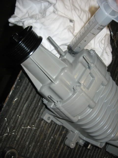

PostSubject: Re: Supercharger oil (Series I SC)   Thu Sep 08, 2011 4:02 pm
nope. They all have it. Yours is right where this syringe is sticking:
