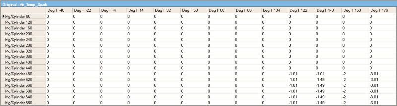

| If you look at the IAT table, it will show you that on the riv (a 97 supercharged anyway) the most the IAT chip can do (assuming factory tune) is command the base timing table. In other words, the only thing that our IAT table really allows to happen is retarding timing when it sees a hot temp coming in. You can put a pellet that says its negative 100 out and it will still command 0 advance as it would at 60 degrees.
Other tunes will have different results, of course. Even the GTP's tunes that I've seen can add a few degrees of advance on the stock IAT table.
Quick answer, an IAT chip will do nothing for this car | |

| Furthermore, even if we assume a resistor could alter IAT sensor input in order to advance spark timing (the premise behind these 'performance chips'), it won't work with our engines, as the PCM is programmed to give no timing advance from cooler air (increased resistance on the IAT circuit). Take a look at our IAT vs. Spark map: See all those 0s at ambient temps or lower? That means no spark advance. You must reprogram the PCM to benefit from messing with IAT sensor values. Or to say another way, VENDORS OF IAT TRANSLATOR PRODUCTS MUST KNOW MORE ABOUT EACH CARS' SPECIFIC PROGRAM BEFORE MAKING THEIR CLAIMS. These are snake oil products, and should be made illegal. If you own a Riviera, NEVER BUY!!! _________________ '05 GTO 6.0L • 6-spd • 95k miles • 0-60: 4.8s • 16.9 avg MPG • Nelson Ledges Lap: 1:26'95 Celica GT 2.2L • 5-spd • 165k miles • 0-60: yes'98 SC Riviera • 281k miles • 298 HP/370 TQ • 0-60: 5.79s • ET: 13.97 @ 99.28 • 4087 lb • 20.1 avg MPG • Nelson Ledges Lap: 1:30 3.4" pulley • AL104 plugs • 180º t-stat • FWI w/K&N • 1.9:1 rockers • OR pushrods • LS6 valve springs • SLP headers • ZZP fuel rails KYB GR2 struts • MaxAir shocks • Addco sway bars • UMI bushings • GM STB • Enkei 18" EV5s w/ Dunlop DZ101s • F-body calipers EBC bluestuff/Hawk HP plus • SS lines • Brembo slotted discs • DHP tuned • Aeroforce • Hidden Hitch^^^ SOLD ^^^ '70 Ninety-Eight Holiday Coupe 455cid • 116k miles^^^ SOLD ^^^ | |
