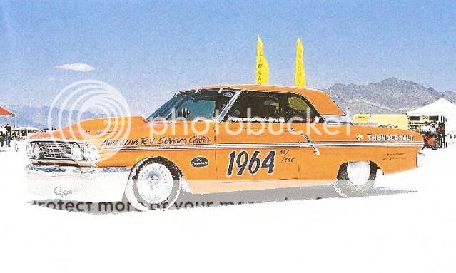

| Here's another one: The Brian & Celia Dean '64 Ford Thunderbolt "AA" Classic Gas Coupe This car's 209 mph speed successfully beat Todd Low's 188 mph record in the first few days of SpeedWeek 2008, but then got knocked out of the record spot by the Hot Rod Special (now "SoAl Special") Camaro. Even so - notice how the air dams are all similar. The rules pretty much eliminate doing anything much more "creative". | |
