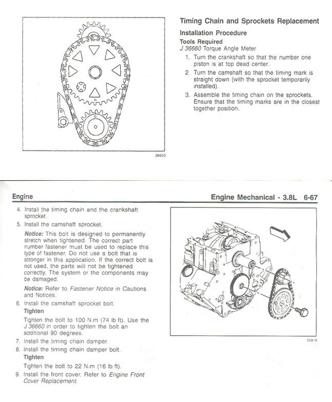

| I just got the Rollmaster chain today. will try to start the job tomorrow. I'll post info from the manual as I get to it. So far, I've read the sprocket bolt is a one-time use (stretches when torqued), so will need to pick up a new one from GM. Here's the RM: _________________ '05 GTO 6.0L • 6-spd • 95k miles • 0-60: 4.8s • 16.9 avg MPG • Nelson Ledges Lap: 1:26'95 Celica GT 2.2L • 5-spd • 165k miles • 0-60: yes'98 SC Riviera • 281k miles • 298 HP/370 TQ • 0-60: 5.79s • ET: 13.97 @ 99.28 • 4087 lb • 20.1 avg MPG • Nelson Ledges Lap: 1:30 3.4" pulley • AL104 plugs • 180º t-stat • FWI w/K&N • 1.9:1 rockers • OR pushrods • LS6 valve springs • SLP headers • ZZP fuel rails KYB GR2 struts • MaxAir shocks • Addco sway bars • UMI bushings • GM STB • Enkei 18" EV5s w/ Dunlop DZ101s • F-body calipers EBC bluestuff/Hawk HP plus • SS lines • Brembo slotted discs • DHP tuned • Aeroforce • Hidden Hitch^^^ SOLD ^^^ '70 Ninety-Eight Holiday Coupe 455cid • 116k miles^^^ SOLD ^^^ | |

- So far, I've read the sprocket bolt is a one-time use (stretches when torqued), so will need to pick up a new one from GM. Here's the RM:
You talkin about the one for the cam gear? Oh boy - i'm glad i did know that... I hope my chevy dealer has it or i'm pretty much screwed. | |
| Subject: Re: FAQ: P0341 Camshaft Position Sensor (Cam Sensor / Timing Chain) Sat Sep 29, 2007 12:22 pm | |
| Yes, the cam sprocket bolt is part #24501366, sells for $5.55. NO ONE has it in my area. Only way is to drive to Akron (over 100 miles), so I'm putting this project off till next weekend, sorry. Ordered the bolt through GM parts, will be in Wed or so.

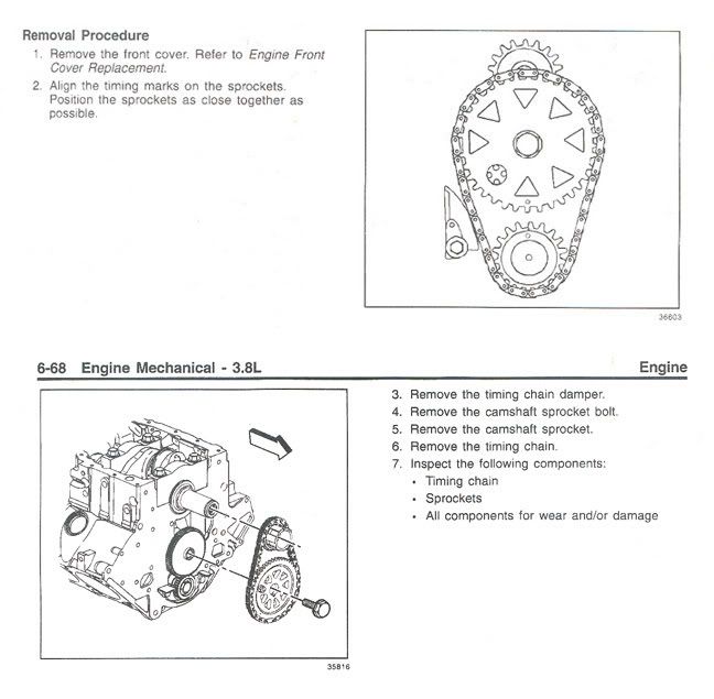

| Here's some shop manual info, hope it helps out: _________________ '05 GTO 6.0L • 6-spd • 95k miles • 0-60: 4.8s • 16.9 avg MPG • Nelson Ledges Lap: 1:26'95 Celica GT 2.2L • 5-spd • 165k miles • 0-60: yes'98 SC Riviera • 281k miles • 298 HP/370 TQ • 0-60: 5.79s • ET: 13.97 @ 99.28 • 4087 lb • 20.1 avg MPG • Nelson Ledges Lap: 1:30 3.4" pulley • AL104 plugs • 180º t-stat • FWI w/K&N • 1.9:1 rockers • OR pushrods • LS6 valve springs • SLP headers • ZZP fuel rails KYB GR2 struts • MaxAir shocks • Addco sway bars • UMI bushings • GM STB • Enkei 18" EV5s w/ Dunlop DZ101s • F-body calipers EBC bluestuff/Hawk HP plus • SS lines • Brembo slotted discs • DHP tuned • Aeroforce • Hidden Hitch^^^ SOLD ^^^ '70 Ninety-Eight Holiday Coupe 455cid • 116k miles^^^ SOLD ^^^ | |
