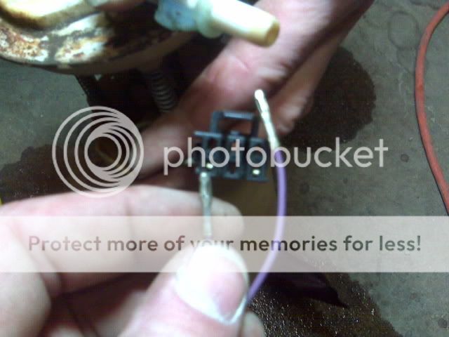

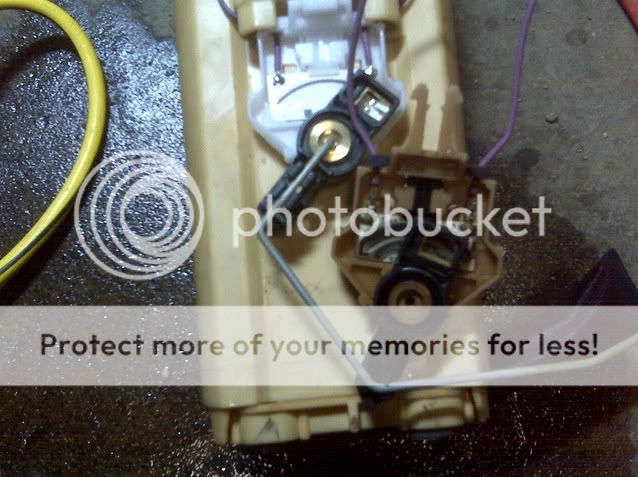

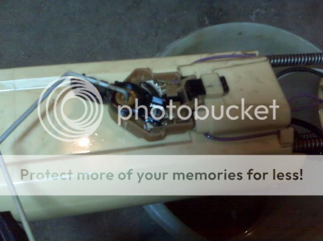

PostSubject: Write-Up: Fuel Pump/Tank Sending Unit Replacement   Fri Jan 09, 2009 11:13 am
The 1998/1999 fuel tank sending unit is a different part number than the 1997 but the wiring schematic shows it to be functionally the same. So I took a chance and ordered a '98/99 unit from ebay since it was too cheap to pass up. I ordered from this guy: http://stores.ebay.ca/evalero1 and I figure I saved over $100 on the parts. The job itself took about an hour and a half, there was a lot of corrosion on the ring holding the pump assembly in the fuel tank so I also cleaned that up at the same time.
Here's the original unit. Once I pulled it out, I could see the contacts were worn right off the rheostat. You probably can't tell in this crappy phone picture though.
The difference in the two units was the wiring harness, the actual rheostat modules looked to be pretty much the same:
All I had to do was to de-pin the old and the new sending units, and re-pin the new one into the old harness. Just insert a very small jeweller's screwdriver or piece of stiff wire in the notch above or below the purple wires and pull the wire out of the connector.
You should probably change the sock on the fuel pump while it's out but I was irritated after laying in the trunk so I skipped it. I tested it out of the tank before I re-installed. If you do this remember that the gauge will move very slowly, regardless of how fast you move the float. It will actually take a minute or two to go from empty to full. Check for fuel leaks before you re-install the access panel.
