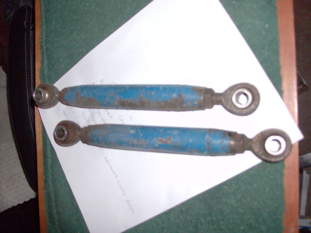

Aww shucks Deek!I'm going to share a pic with you.These are my chrome-moly rear control arms from my old 88 Acura Legend coupe.
FAQ: Shocks & Struts Options - Page 13 HPIM1632
Yup! those component control arms custom made for me by the guys over at competition engineering,lasted me 7 1/2 NY winters! yup there they are covered in their original NY state of mind grime,filth,road tar,salt & all kinds of muckity muck only the pot hole riddled streets of NY can throw at ya.Yup,7 years of freezing salty winters and  thousands of "oopps! i just ran over a pot hole!" moments,and the bearings in their races are still as tight and etch free as the year i bought them.
Those sphericals are not even the kind with a Teflon liner like the ones I currently run,nope,just plain ol' chrome-moly bearings.
I had every intention when i installed them to religiously clean and oil them once a month to keep 'em nice and pristine,never happened.I think I crawled under the car once or twice to check em out but I eventually forgot about 'em at least until i ran into a fast corner and then I just thanked God and Competition Engineering for giving me them.
