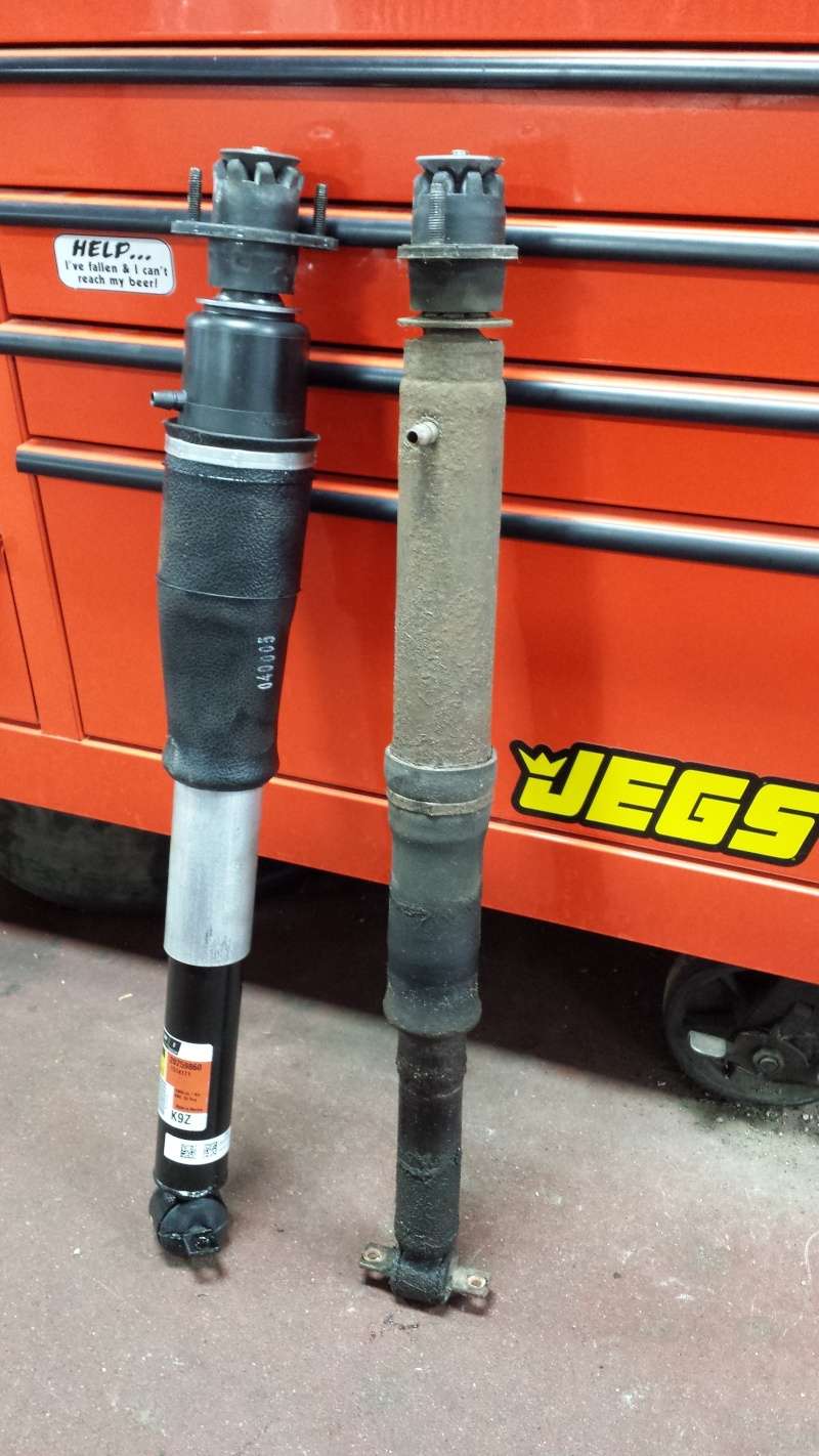

So, I stumbled across something interesting today. I replaced the rear air shocks on an '07 Lucerne. As most of you may know, the Lucerne is damn near identical to the Riv, minus a few updated parts (as far as suspension/drivetrain are concerned). Anywho, there's an updated rear shock design to replace these stupid, crappy air shocks we have. This is a "new" design, much like the Yukon air suspension system.
The one major thing I noticed is that the *new* shocks are fully extended at rest, unlike the stock air shocks on the Riv. I had to physically pull the shock on the right out to make it full length. The new ones also act like a "normal" shock. Compress it, and it extends back up on its own. Now, these shocks are quite pricey. For those of you looking for good, quality air shocks, I'd get these. I'm actually going to put a pair of these on my '97.
These are not Delco's. These are GM factory shocks.
P/N 19300034 RR Shock
P/N 19300035 LR Shock
Another incentive to have them installed is that they come with a LIFETIME WARRANTY.

Very interesting! 195.63 and 194.25 on rock auto... yup pricey. Whats the difference left to right? Weird to have a $1.38 difference.

The position of the upper mount and the air fitting. If you tried putting the left on the right (or vice versa) the fitting would be facing forward instead of rearward.
I drove the car after installation. They aren't mush at all. When I set the car down, with no air in the system, the car was at normal ride height. I actually think there may be a spring inside. When compressed, it goes right back to fully extended unlike a standard shock that takes a few seconds.
