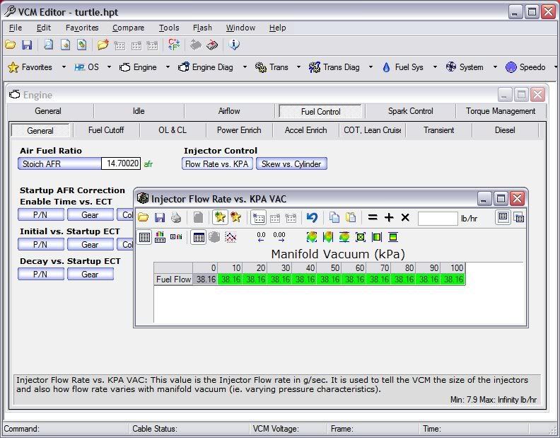

I have a set of new 42lb injectors waiting to go in ASAP. Anyone have a table I can import to use em so I can get them in tonight and shake this vacuum leak?

36 / 42.5 = .847
Multiply your injector flow rates by .847 and you should be good to go. That's it.

36 / 42.5 = .847
That's pretty much it. If you do before and after tuning, you'll find the idle needs a little tweaking afterwards for perfection, but otherwise that's all. You will certainly be fully driveable by just multiplying the IFR table by .847.

so my 38.16g/s across the board becomes 32.32g/s
Does that look right?

Yep, that should do it. thumbsup

CK says 33.7/42.5 because 33.7 is what the stock injectors are at static flow rate

Even if that's true, I don't know why you would use the static value as reference to calculate, because your stock injectors are not going static at idle, cruise, even most heavy throttle (are yours running 100% duty at all?).
If you base your calculation on static value, won't the engine will run rich 99% of the time with the 42.5# injectors?

STOCK INJECTORS
33.71 lbs/hr @ 3 Bar (44.1 psi I think)
34.28 lbs/hr @ 45 psi
12.2 Ohm
42.5lb INJECTORS
Static Flow Rate: 42.29 lb/hr @ 43.5PSI
Static Flow Rate: 48.83 lb/hr @ 58.0PSI
15.9 Ohm
this is ZZP's information but in terms of making an accurate skew, It seems to me like I want to use the 33.7 factor. I'm assuming that the numbers they give for stock injectors are also static.

Interesting numbers. Wonder why they are called "36#" if they only flow 33 lb/hr? If ZZP tested them that low, I wouldn't buy them. Here's a test showing 36 lb/hr:
http://dtcc.cz28.com/flow/index.htm
The way to do this is just pick a number and try it. My suggestion is 32.32 and Kemp's is 30.26 g/s. The lower number risks going lean. I'd be safe and use 32.32 g/s. Scan the engine and watch where STFT goes. If you're (+), IFR needs to go up; if (-), IFR needs to go down.

Ok I installed the injectors, imported the base LQ4 table and the 32.32 in the IFR table. The car runs fine below 50% throttle and fuel trims are pretty good. It stays at or close to zero and deviates negative if anything. I tried using the 30.26 factor in the IFR table and have nearly unchanged scan results. My problem is that above about 50%-60% throttle, the car seems to loose all power and it happens consistently. I suppose it happens when fuel trims lock? Anyway, I'm confused as hell here.

Is your IFR table static values? Mine isn't. What are you tuning with? DHP or HPT?

Photobucket
HPTuners
That's my table

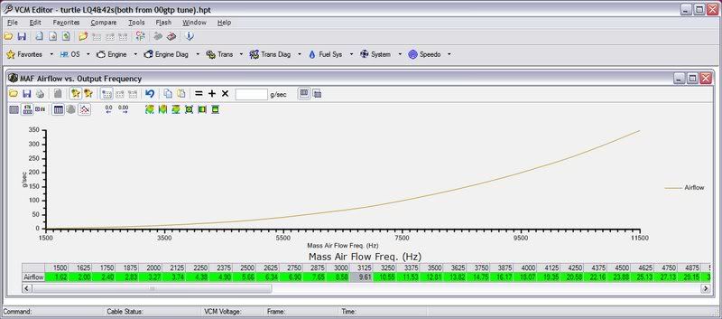

It was a clusterfuck. I got the injectors in part to replace my old ones which I believed had bad seals that were causing a major vacuum leak. I also made a special maf tune before to drive the car with the vacuum leak. Basically , the idle to vacuum ranges were hopelessly lean and above that point in throttle I was pretty close to zero and stable.
So I had a very skewed maf tune before I did the injectors that would not be acceptable under normal (no vacuum leak) circumstances. When I installed the new injectors, I imported the base LQ4 maf table and changed the IFR table at the same time. Additionally, I used the VCM controls to reset the learned fuel trims because I figured it would be grossly wrong anyway and I wanted a clean slate to start with.
Update, I've been driving the car a bit today and It just doesn't seem like anything wants to stabilize. When I open up the throttle, the trim locks at a value somewhere around -10 and the car doesn't get all retarded like it did but it still lacks power. I would say it's better than it was before but not nearly what it should be. I can have some trouble starting it lately too. It won't really want to start unless I give it some throttle. Again, this seems like a over-enrichening (word?) problem. This maf table I'm running right now should be damn close to perfect if nothing else was changed so I still think something is wrong with the IFR or something concerning fuel control. I've done plenty of messing around with the maf table before I ever touched the fuel system and never had results as poor as this.

In effort to try to learn more, I visited HPtuners tune repository to study some tunes from others with similar stuff. The closest thing I came across was a '00 gtp with my injectors and maf sensor among other things. This is what his stuff looks like...
Photobucket
Photobucket
Note I changed to metric so it's not going to compare very well to what I've shown in above posts. It looks like he did something more like what Bill showed me for the IFR's. This maf table is not much different than my lq4 table. It just has a slight increase across the whole curve. I was hesitant to do this but I just imported his maf table and IFR table (didn't reset trims or anything) and wouldn't you know it the car started up and drove fine. All my power seems to be back. I've only taken one test trip with this tune in but I scanned every second of it and from what I've looked at so far, trims are much better already.
