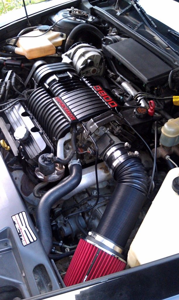

| Subject: Re: Write-Up: Flexible Tube Fenderwell Intake Sun Jul 14, 2013 7:18 pm | |
| Can I ask why? No offense but it looks terrible and amateurish. Even the PVC pipe looks better IMO. | |
llamalor2112 Junkie
Name : Evan Age : 31 Location : Granite Falls, WA Joined : 2012-07-13 Post Count : 852 Merit : 13
| Subject: Re: Write-Up: Flexible Tube Fenderwell Intake Sun Jul 14, 2013 8:23 pm | |
| Terrible and amateurish? If we're speaking purely cosmetics I think it looks a hell of a lot nicer than some stock or even box setups. Imo of course | |
| Subject: Re: Write-Up: Flexible Tube Fenderwell Intake Sun Jul 14, 2013 8:54 pm | |
| I think the flexible tube is appropriate for race applications. You see it a lot at the track where tweaking and tuning happens. A flexible tube is, well, flexible for different set-ups. For a production look, it doesn't quite hit the mark of a molded or machined part that fits exactly one application. So yes, it may look amateurish, but certainly not terrible. And amateur isn't always a bad thing, sometimes can mean more fun! _________________ '05 GTO 6.0L • 6-spd • 95k miles • 0-60: 4.8s • 16.9 avg MPG • Nelson Ledges Lap: 1:26'95 Celica GT 2.2L • 5-spd • 165k miles • 0-60: yes'98 SC Riviera • 281k miles • 298 HP/370 TQ • 0-60: 5.79s • ET: 13.97 @ 99.28 • 4087 lb • 20.1 avg MPG • Nelson Ledges Lap: 1:30 3.4" pulley • AL104 plugs • 180º t-stat • FWI w/K&N • 1.9:1 rockers • OR pushrods • LS6 valve springs • SLP headers • ZZP fuel rails KYB GR2 struts • MaxAir shocks • Addco sway bars • UMI bushings • GM STB • Enkei 18" EV5s w/ Dunlop DZ101s • F-body calipers EBC bluestuff/Hawk HP plus • SS lines • Brembo slotted discs • DHP tuned • Aeroforce • Hidden Hitch^^^ SOLD ^^^ '70 Ninety-Eight Holiday Coupe 455cid • 116k miles^^^ SOLD ^^^ | |

| I guess I shouldn't say terrible, but why go with flex tubing when there are more proven and cost effective options available? Not to mention more aesthetically pleasing.
I went with Chris Davis' 3.5" Spectre FWI. It looks amazing with the aluminum finish and fits in the fender-well very well. In my opinion, that's the best aftermarket cold-air intake system available for our Rivieras. However, with that said, I'd still trade my intake any day for AA's beautiful custom intake. It's too bad he didn't mass produce those puppies. | |
