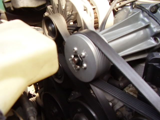

| Heres a few pics of mine... putting the MPS Hub on: then this is how its set up to remove,notice the plate will sit on the back of the pulley vs. the front when removing...it also comes with copper anti-seize for lubrication of threads,and the 2 washers.
Last edited by TType_Riviera on Wed Mar 12, 2008 2:46 pm; edited 1 time in total | |
