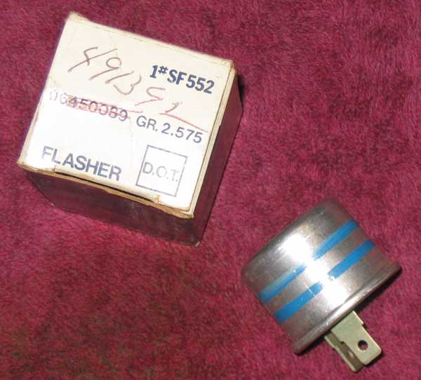

PostSubject: Re: Turn Signal & Hazard Flashers - Location/Troubleshooting   Thu Mar 19, 2009 5:41 pm
Yes, take out screws, pull down plastic panel, flasher is silver thing that looks like this:
Sorry, I mean like this:
Get it at any auto parts store. I think it's around $5-$10.

PostSubject: Re: Turn Signal & Hazard Flashers - Location/Troubleshooting   Fri Mar 20, 2009 12:30 am
DUDE... AA your a lifesaver THANK YOU VERY MUCH... it was the flasher smile although.. there is TWO flasher up there.. its the one with the red end thing on it.. ugh that was confusing.. anyway THANKS for the help A LOT
