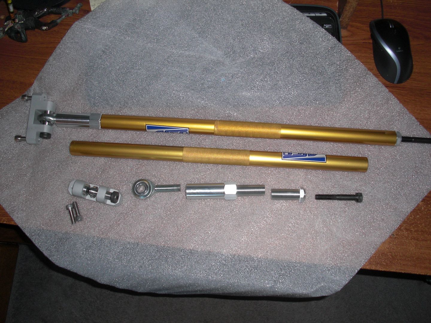

tortuga - Page 31 CIMG5601
and I present to you a drag racing rear suspension
I wonder how dangerous this will be..
Anyway I decided to purchase aluminum tube and make ends - 3 pieces instead of using 1 piece of solid bar stock mainly because this way is much lighter and after all this is for drag racing. According to my bathroom scale, the assembly & hardware weighs about 2.2lbs. So I did spend like fourty-something on the bars. I'm gonna install and drive around on the street briefly just to make sure It's not too psycho to handle over bumps and stuff and then just bring ramps and a jack to install at the track which I recon should be about as quick as changing tires.

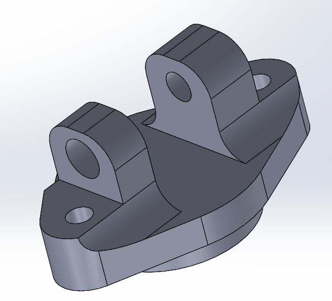

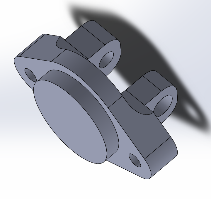

The solid rear suspension was way too psycho. I drove about a mile with it no faster than 35mph and said no way. Just backing the car out of the driveway the back end was bouncing like mad over every tiny irregularity in the asphalt - you wouldn't even call it a bump if you have any suspension at all. I can definitely see loosing control of the car at speed. So I'll just move forward with the coil over retrofit since the control arm mounts are already made. I just finished designing the upper tower mount.
tortuga - Page 31 2
tortuga - Page 31 1
principally the same as the lower mount
I'm counting on being able to turn the heim joint of the coilover around to have the upper and lower in a perpendicular orientation to one-another. My upper mount goes forward-back while the lower is side-to-side. Those who have the coil-over setup done, you can do this right?

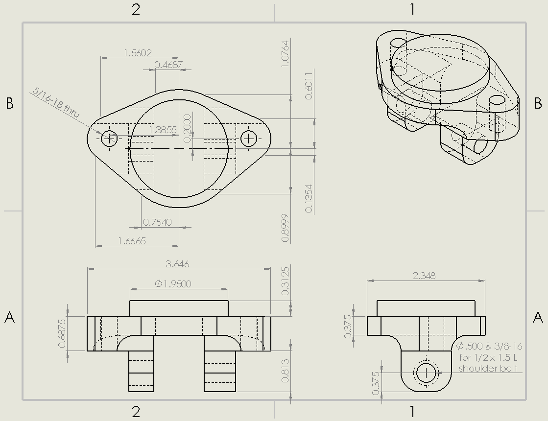

tortuga - Page 31 1_1
Also this is based off my initial measurements of the stock top mount. I'm going to machine the profile and holes on a scrap piece and check it against the mount and stuff and see how much i'm off then make a corrected drawing and make 'em. Once I confirm a good mapping, I'll copy my drawings over to the coil-over thread. Also a threaded hole could easily be added in the middle of that mount to have a super simple rear brace added. I'm thinking about maybe using those aluminum bars I purchased to do that since they aren't doing anything else now
