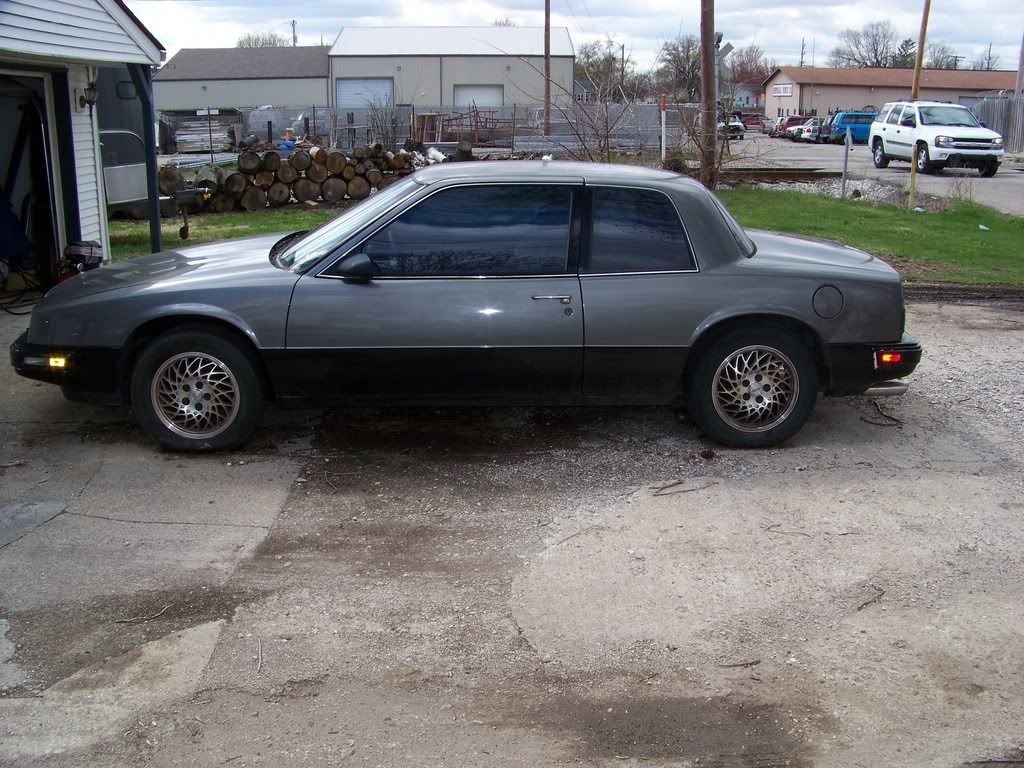

Here is A View of the Outside
1 of a kind Riviera Outside

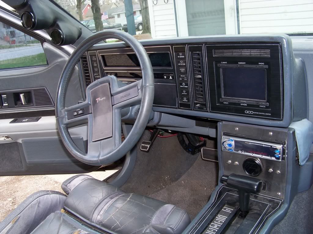

Here is a View of my "Cockpit" SO many switch levers and lights
1 of a kind Riviera Interior

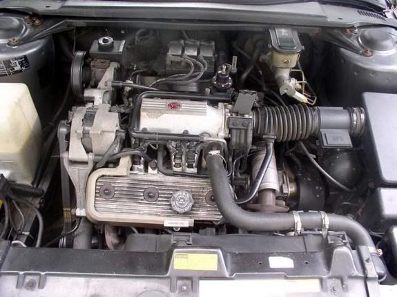

My Motor Looked Like this Originally
1 of a kind Riviera Motor2

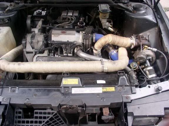

Here is My Modded Motor.. I was Running 14.08 1.4s before methanol injection
1 of a kind Riviera RivMotor
