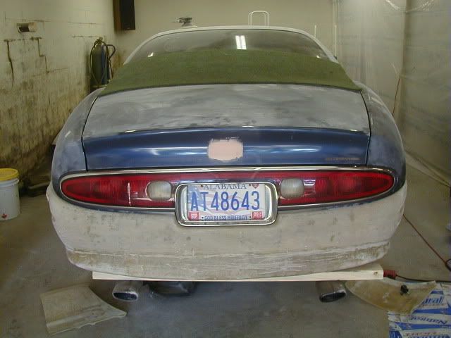

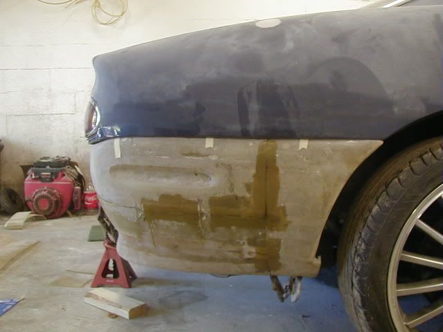

Here are some progress pics of the body work.
The plan is to pull the bumpers into the car some. Similar to Jack the R's photos in his signature.
First fiberglass was laid on the stock bumper cover to get a shell to start with. This part will eventually become the "plug" for a mold to make the new bumper cover.
Write-Up: Front & Rear Bumper Modification P1010025
Write-Up: Front & Rear Bumper Modification P1010026

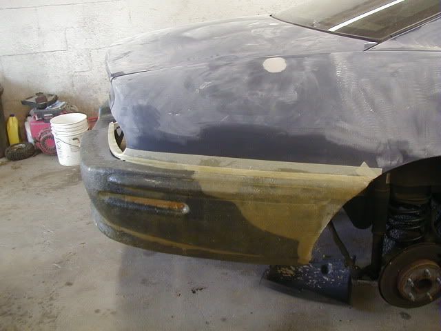

Then the process of cutting, reattaching, shaving, adding, grinding, sanding......you get the idea.
Write-Up: Front & Rear Bumper Modification P1010029
Write-Up: Front & Rear Bumper Modification P1010032
The shape is getting there. Notice the trunk lock has been shaved as well.
Write-Up: Front & Rear Bumper Modification P1010031

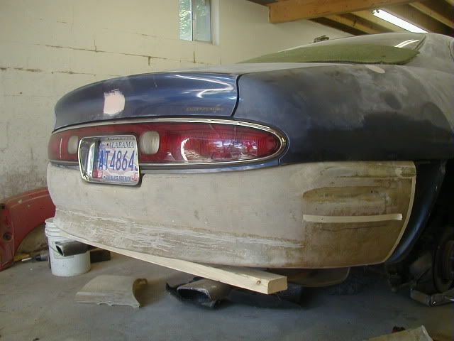

No more antenna either. The bumper is close. Just some minor shaping and it is ready for the mold process.
Write-Up: Front & Rear Bumper Modification P1010038

Wow, I'm shocked you were able to take it in that far! All that bumper that sticks out 5 inches is just empty space?!
I've got a couple suggestions -
Write-Up: Front & Rear Bumper Modification Rear_suggest_01
The trunk lid shouldn't overhang the bumper. You need to put a bit back on.
The side reflector needs to come forward a bit.

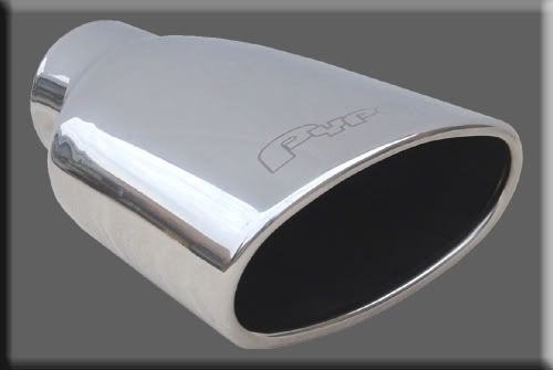

Will the exhaust tips be oval or elliptical?
I like the overall effect. I am looking forward to seeing what the front looks like also. Will you just pull the bumper in or also create a more pronounced front air dam under it?
sqrivi
Location : madison, al
Joined : 2008-03-15
Post Count : 375
Merit : 52
Write-Up: Front & Rear Bumper Modification Empty
PostSubject: Re: Write-Up: Front & Rear Bumper Modification   Write-Up: Front & Rear Bumper Modification EmptySat Jul 04, 2009 1:35 pm
Here is what I got for the exhaust tips.
Write-Up: Front & Rear Bumper Modification Evt28
