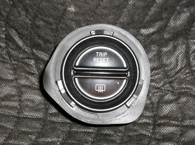

PostSubject: Re: Trip Set/Trac Cntrl Switch Illumination   Mon Jul 20, 2009 11:22 pm
Im not sure if anybody really gives a shit or not but I thought I would clarify this some
On the 95, the switch is for TRIP RESET/REAR DEFOG, IS illuminated, and the TRACTION CONTROL button is located on the left side of the knee bolster, and it is also illuminated.
Im guess here, 96 and newer, I know it is on the 99, has the REAR DEFOG button with the HVAC controls on the dash and the switch in question is for TRIP RESET/TRAC CONTROL for those years, it IS illuminated on my 99.
I have added pictures of the 95 switch and the bulb if anyone is interested, Im guessing again here that the switch at least resembles this one for the later years and the bulb would be replaceable, just not sure of availability?
The advantage of having spare parts lying around, pictures come a little easier.
Just thought Id clarify some, like I said if anybody really gives a shit!

PostSubject: Re: Trip Set/Trac Cntrl Switch Illumination   Mon Jul 20, 2009 11:44 pm
That bulb looks like one of the GE #74 or #194 type. Does the bulb have a number printed on it? As for the #74, sometimes WalMart has them; pretty much all the time you can find them at Advantage and AutoZone. In CLEAR though. Sometimes you can find the #168 in turquoise or green. For a clear bulb, to get the turquoise you will need a paint marker, available at a craft store. THey are intended for painting "stained glass" for hobbyists BUT wonder of wonders they are the perfect color for incandescent dash bulbs. The marker is the Vitrea 160 "glass paint" "glossy marker" #116084, UPC 3-167861-160841. It comes with instructions for glass - BUT basically what you do is clean the bulb with 91% or stronger alcohol (not drinking hooch, just drugstore Isopropyl), then put the bulb back in holder (for convenience) and allow to air dry. Then evenly paint one coat of the glass paint on the bulb; do NOT give a second coat, do NOT overlap strokes, do NOT leave white/clear spots (don't worry you'll get the hang of it and if not just use alcohol and a paper towel to get the paint off, rinse with alcohol and allow to air dry, then do it again). Allow the paint to air dry (IIRC takes an hour or so) then reinstall the bulb. The paint will bake on with the heat from the light when operating.

PostSubject: Re: Trip Set/Trac Cntrl Switch Illumination   Tue Jul 21, 2009 1:44 pm
No part number on it, not a #194, don't know about a #74 though? I tried looking for it in my crash manual and the service manual but no part number listed? The blue covering is a rubber like substance and the bulb is wired directly into the base. Ill look a little further and see what I can find.
Post Count : 6868
Merit : 131
PostSubject: Re: Trip Set/Trac Cntrl Switch Illumination   Tue Jul 21, 2009 1:54 pm
If you can tell me how big is the bulb I can figure it out.
If the bulb is hard-wired into the base, you could replace it with a grain-of-wheat bulb. Same paint-pen drill as I described above to get it the right color. If you happen to find any number that would help. If I got a better look at the bulb - odds are that one of the LED sites selling instrument panel bulbs has them made up already.

PostSubject: Re: Trip Set/Trac Cntrl Switch Illumination   Wed Jul 22, 2009 7:47 pm
The one I pictured still works so I don't want to tear it apart just now. I should have time this weekend to give you some sizes, or at least a comparison to a 194, if you want to figure out what it might be.
I did call the dealer and their answer to a bad bulb is to replace the whole switch! Not a good answer when a $0.99 bulb would/might fix the problem?!?
