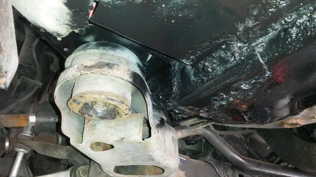

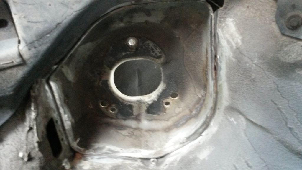

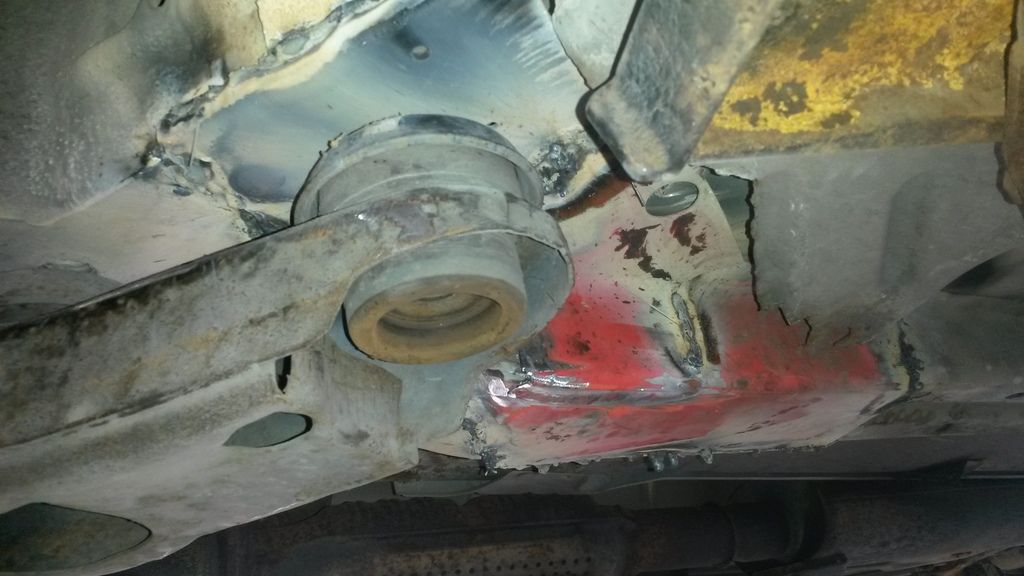

PostSubject: Holy Shishkabob!    FAQ: Rust Areas & Concerns - Page 4 EmptySun Jul 05, 2015 1:07 pm
Been looking for a mysterious clunk and after major surgery on the strut towers, the frame where the cradle bolts to was completely rotted away! Wow. After almost two years of mechanics looking at this car no one saw this until now. In any case, part of a 1981 Gravely mower deck is now part of my new frame! My neighbor, mechanic is an artist! Welded and rebuilt the entire section. I know anyone who buys this car is getting a TANK! We're going to weld a few more pieces in the back as well. In the meantime this car drives amazing now. Forgot how awesome this thing drives.
FAQ: Rust Areas & Concerns - Page 4 20150705_111521_zpsasppfqvu
Subframe Bolt floppin around!
FAQ: Rust Areas & Concerns - Page 4 20150703_112321_zpsvplhshhi
Tower work!
FAQ: Rust Areas & Concerns - Page 4 20150705_111600_zpsgqfoy9z2
Gravely Orange!
FAQ: Rust Areas & Concerns - Page 4 20150705_121403_zpsw2ofxytq
Right in front of RSSA
FAQ: Rust Areas & Concerns - Page 4 20150705_121803_zpsyayuqoqn
All Better now!
http://myspace.com/theacetomato

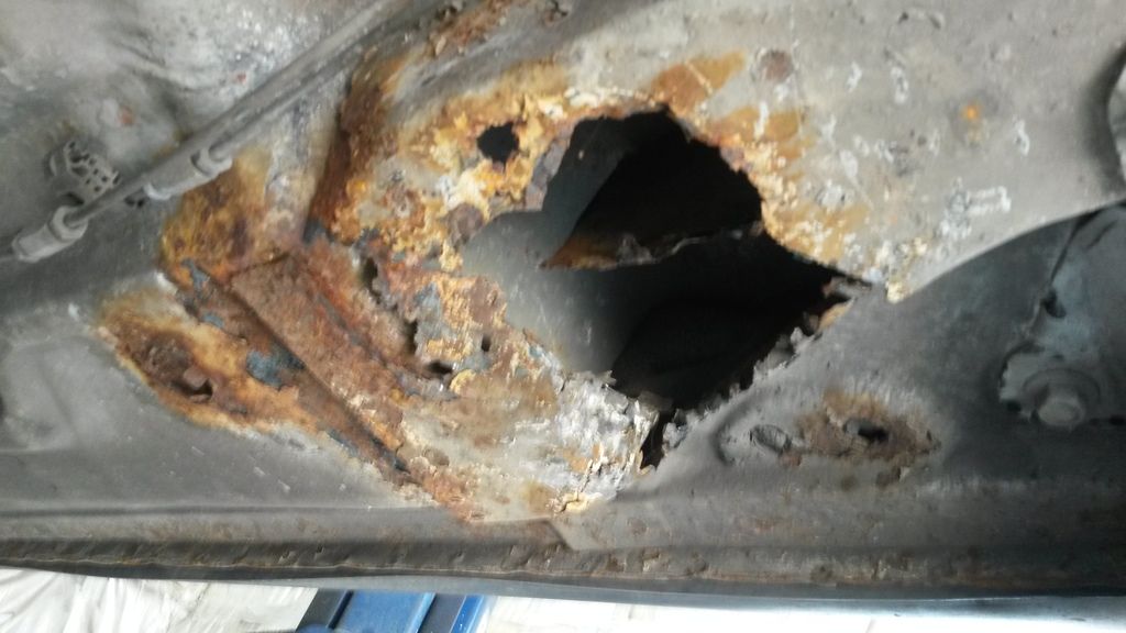

OK guys I just found some rust on the passenger side rear jack point, right in front of the rear wheel. I pulled up on the plastic panel and all this sand and rust poured out..now I'm scared big chunks too. What can I do to stop this process?? Where else should I look for rust I know engine cradle also
