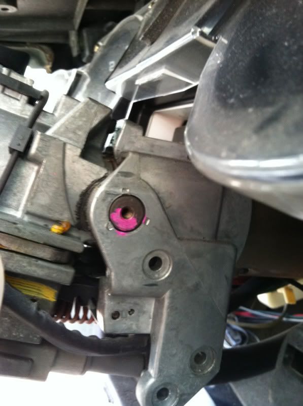

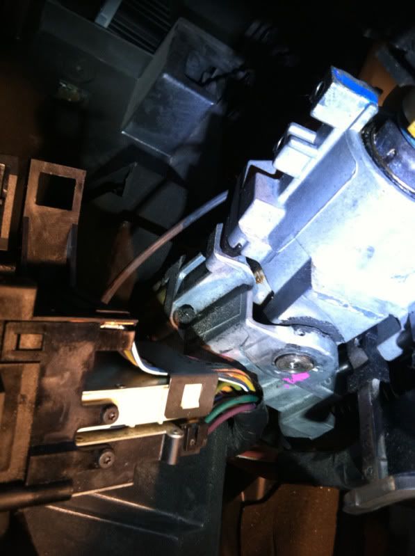

Okay, enough is enough. I have a track day coming up next week, and damned if I'm going to take this car through a twisty road course with the steering wheel bobbing from 8-2 o'clock. Autocross, okay, high-speed racing, not a chance. I read through this thread (thanks to all who contributed) and considered a few approaches.
Yesterday I began by carefully removing the dash panel (also good opportunity to replace a burned out dash cluster lamp). With the dash out, I got the steering column panels off, and now the all-to-familiar adjustable column brackets, sans right side pin:
Here's a closer look, with the pin reinstalled. It's been out of commission for a few years:

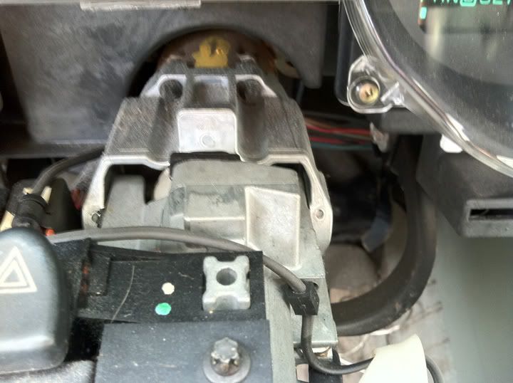

Bracket looks to be in good shape:

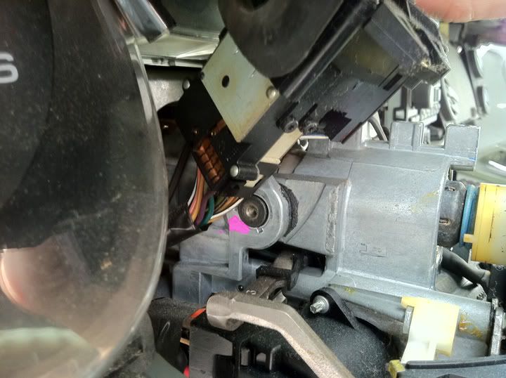

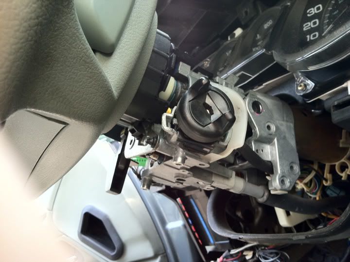

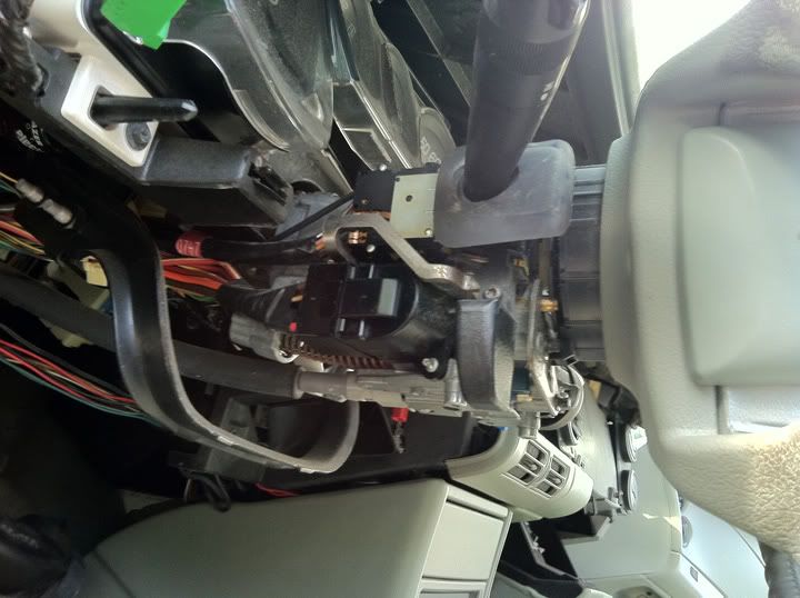

Here's the left side, with control stalk still attached:
And with the stalk removed (this pin did not fall out, as it was blocked by the stalk):
First thing I did was reinsert the right pin and test the steering wheel for slop. The right pin fit snug, and immediately I noticed the situation had improved, but the wheel was still wobbling, this time with movement on the left side. What had happened was the left pin, which had been permitted to slop around for tens of thousands of miles, had worn the inner bracket hole to a larger diameter. So even with both pins installed, the situation would not be fixed.

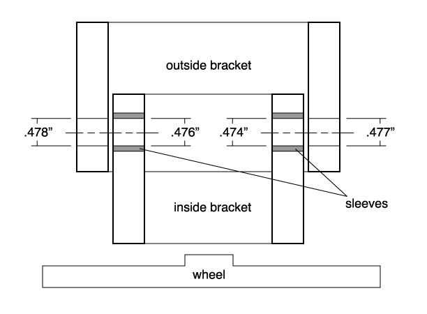

I also noticed the inside metal bracket contained a hardened steel sleeve to accept the pin, while the outside bracket had no sleeve. What this means, I think, is the engineer(s) thought they would press the pins into the sleeves of the inside bracket with a force fit, letting the pin pivot in the outside bracket hole. This explains why there are no splines or knurling on the outer part of the pins. In theory, the pins would be held in by the force fit, but for whatever reason, the interference was not sufficient to keep it there, or the seal was not as hard as they thought.

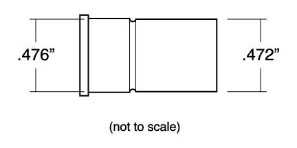

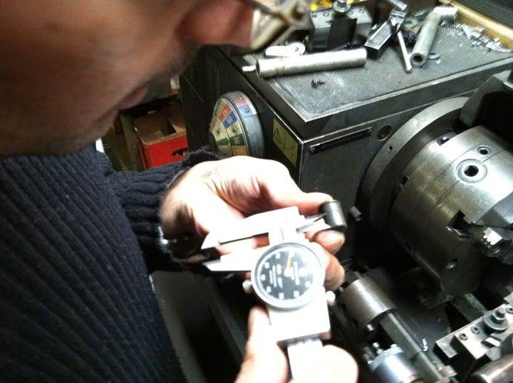

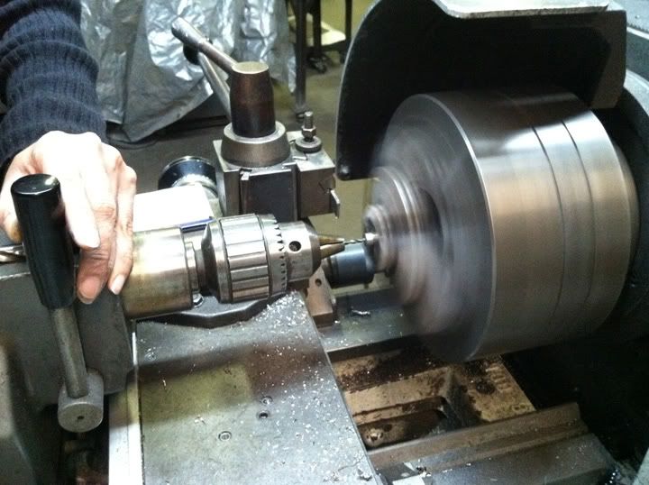

I contacted a friend of mine, who's a wizard on the lathe, and we talked about options to fix this WITHOUT removing the brackets. He produced a set of pin gauges, in steps of .001", which we used to capture an understanding of the bracket hole sizes, as they are now. Inserting them one at a time into the holes, we deduced the following:
The above is looking down on the column, sitting forward in driver seat. The left side holes were worn much more than the right side. My friend suggested we make new pins that would create a new force fit with the existing brackets - by matching the new numbers nearly exactly. He had keys to a machine shop, so I knew he meant business.

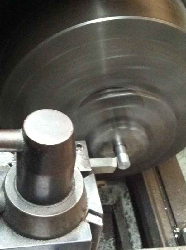

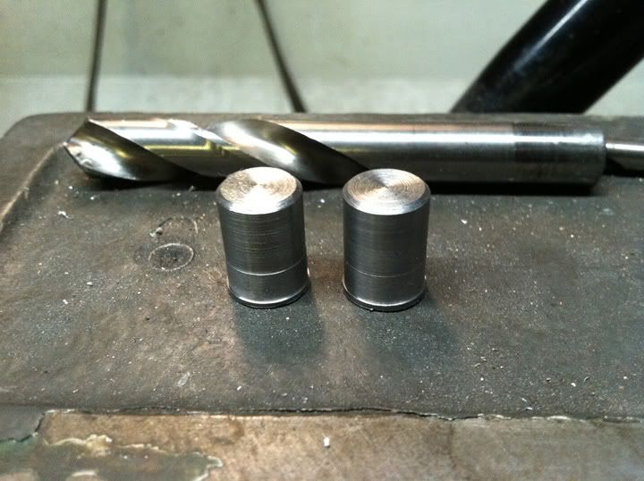

We started with a common piece of .5" dia bar stock steel. Taking a few length measurements from the OEM pins, my friend knocked out both pieces in less than an hour. He even drilled and tapped the backs in case we ever need to remove them:
Voila. You can see the slight differences near the steps:
Next we fitted the pins. They went in super tight, a perfect fit. I tapped them with a hammer to start, then used a C-clamp to press in. It took a bit of effort, so I don't think they'll be coming out any time soon:
Here's a shot of the left side pin pressed in:
In total, I probably spent 4 hours taking the dash out and reassembling, and one hour of my friend's machine time. The best part is material cost was next to nothing, and when I finally took the wheel in my hand, oh man, it's tight! It's tighter than I can ever remember it being, even 8 years ago. Once I get the new brake pads on, this car will be ready for the track!
