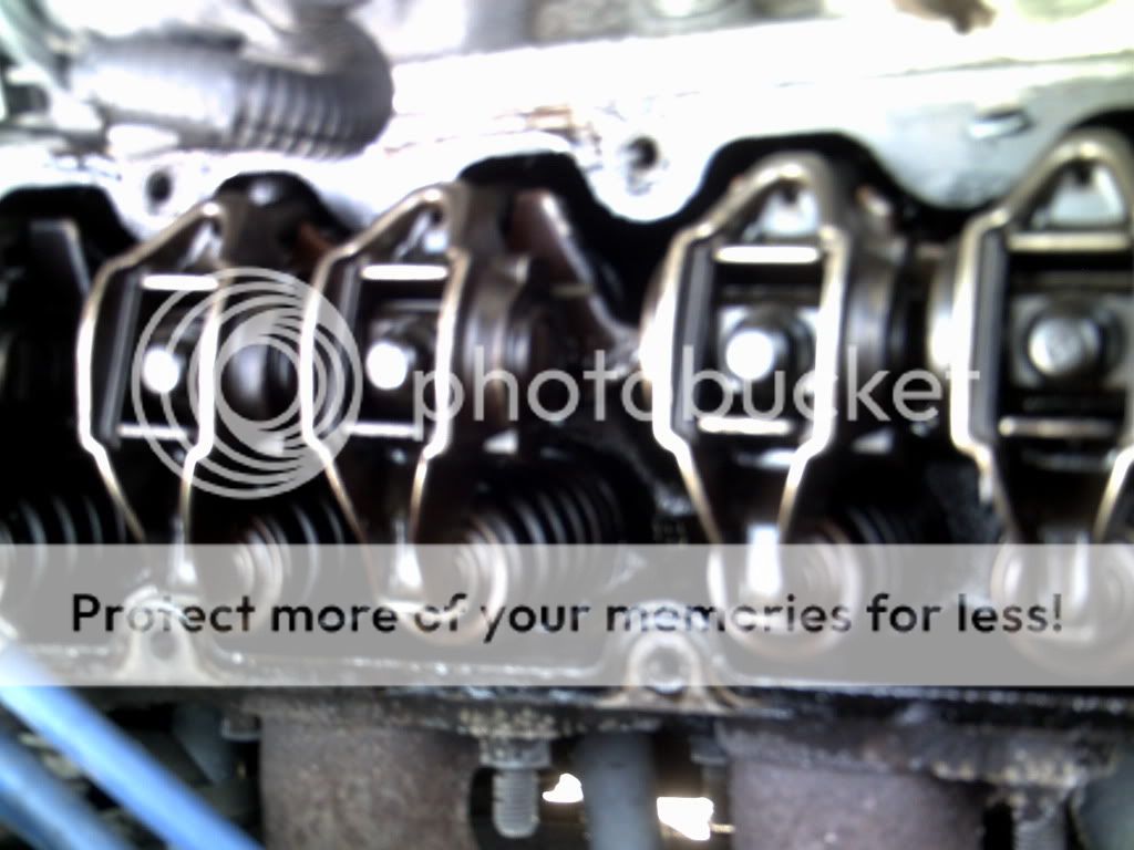

I pulled of the front valve cover, it looks pretty clean under cover. the top of cover itself has the yellow milkshake stuck to it, none on valves or head, just on top of cover, feels like butter.
PostSubject: Re: Low oilpressure, Oil pickup Stalactite   Sun Jan 10, 2010 6:42 pm
The 'Yellow Milkshake' definitely indicates coolant in the oil. Fixing the coolant source, and a few oil changes later it should be gone. But that stalactite still scares me. Hopefully you don't have long-term issues from this.
The good news is that you can get 3800 short blocks used for pretty darn cheap. No need to rebuild yours unless you are after a performance buildup. In general, the 3800 bottom end is good for at least 200K miles with only basic care, many have much more than that.
