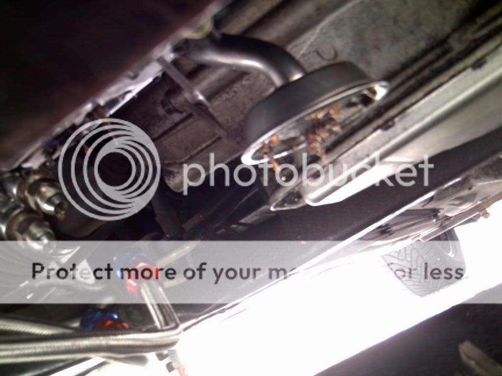

Cleaned the engine again from below, a lot more stuff flushed out.
The drain plug clogged when I was draining the oil, so I dropped the pan when it was still up to the level sender.

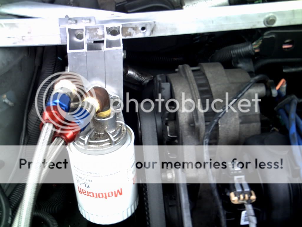

The remote adapter that attaches to engine is stuck on. I would have to put prybar between fitting to turn it( I would rather not for fear of bending aluminum.). The one on the strut tower came off okay. Passages were clear, and it had the sharper bends and smaller gaps of to two, so the other should be Clean too.

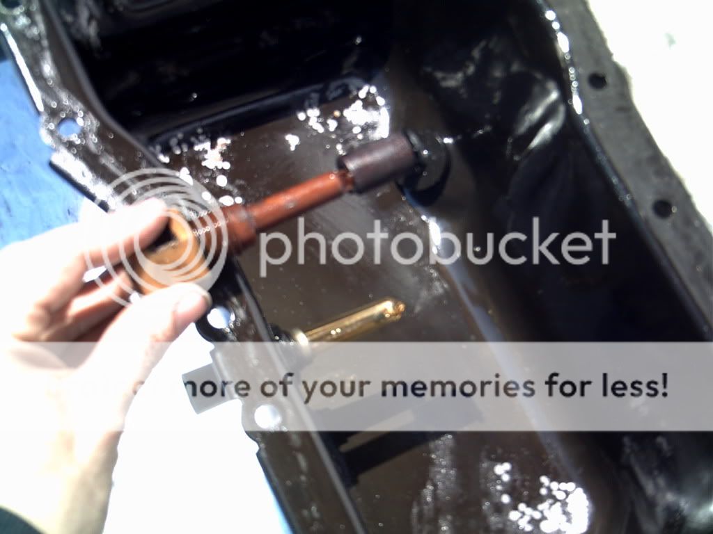

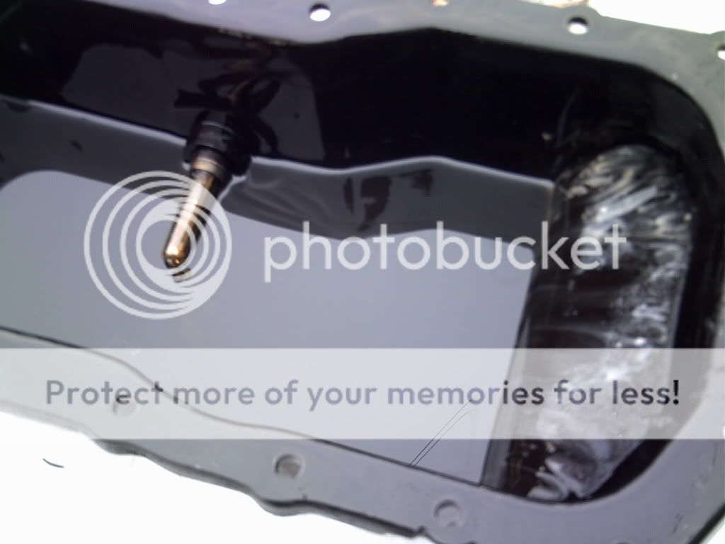

Dropped pan, partially full from paper clog in drain plug again. Pick up only has a little on it. Most of the paper seems to be snagging on nicks in openings of windage tray. I'm using windage tray from friends blown motor(he had piston ring come out top of piston & broke the rod, while driving at 30mph), lots of little nicks to snag the fibers.

Most of the paper seems to be snagging on nicks in openings of windage tray... lots of little nicks to snag the fibers.
Hey, an auxiliary cellulose filter... That's not a bug, that's a feature!

Yea it it is helping. I was tempted to get a file an serrate the edges of the drain holes, but figured the nicks already there are doing a good enough job.

Some quick comments:
1) I don't understand "Ford Filter on a Buick." When you have a moment please explain.
2) A look at the filter - without cutting it open - should tell if any of the filter distintegrated. I doubt it. What I've seen and been told about is the glued-on end boards on the Fram filter come unglued after a while, usually somewhat after the 3000 mile recommended change interval. I have not heard of the filter media dissembling. So if you still have the old filter, look in the big hole in the middle. You should be able to see the filter media through there. Secondly - if you are going ot cut it open you really might want to have someone who does not care about the outcome witness it. You might even want to call Blackstone and see if they will do it.
3) After thinking about it I really doubt it's the filter, if only because I'm not aware of any filter media in use that will decompose in engine oil. But without the old filter, don't know/can't test.

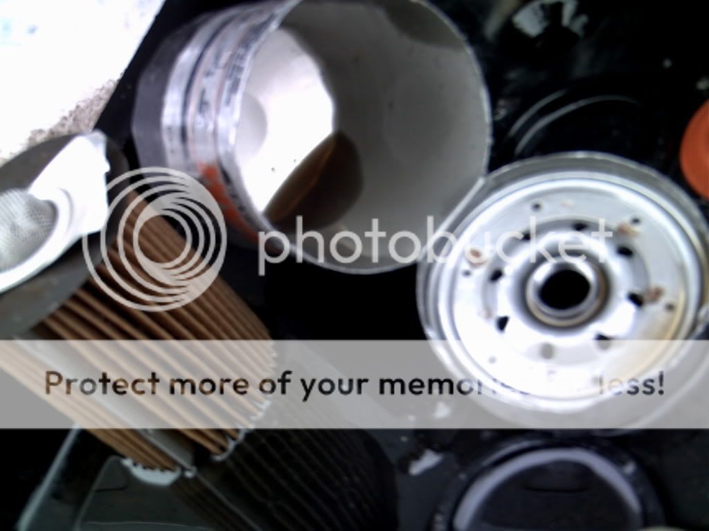

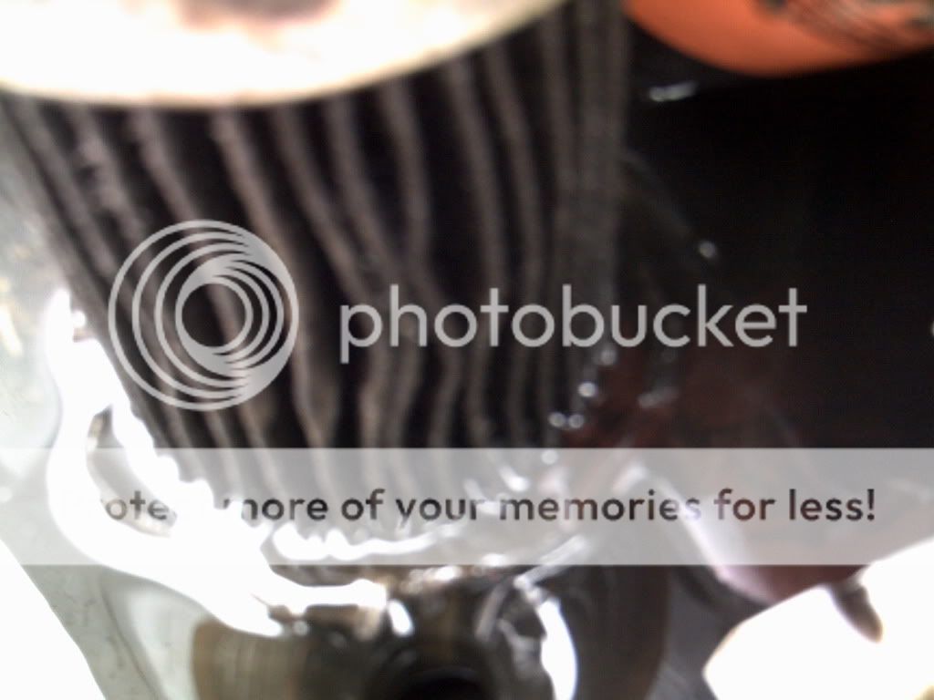

I said ford filter on a Buick because the normal application for the filter am using is 4.9 straight 6 Ford f150, and likely other engines/models. The one on now is even a Motorcraft, only non-fram I could buy at Walmart(besides supertech, they make Fram look high-end by comparison).
I saw the recommendation to have someone watch the filter cutting after i cut it open. The filter didn't fail though, unless the Mobil 1 the dealer changed was the culprit (I doubt it).

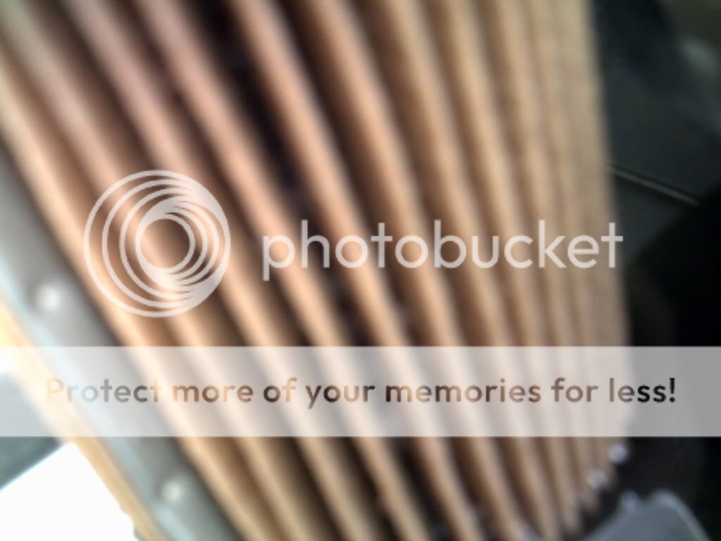

Close up of element

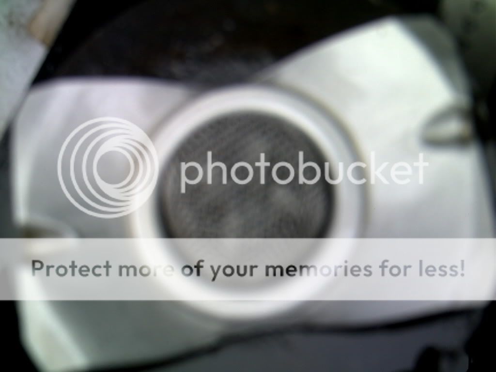

I also cut open on of the Fram TG-8 I used when flushing.
Pictures kind of fuzzy, but It looked clean to me, wouldn't change an air filter that was that clean. Red color is probably from Gunk flush.
The Tough guard has a screened bypass, about the same mesh as the pickup, No sign of fibers.
The pickup screen is getting cleaner each time.
After cleaning this stuff off again, I ran it over an hour with no light. I'm going to drop the pan in morning and strain the oil. It had about 1/4 the paper this time, at that rate it should be cleanish soon.
