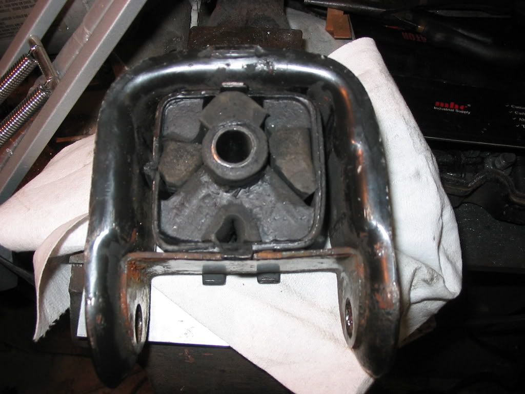

used a non GM insert, got the good mounts for 12$ each plus steel for shimming the new inserts with steel shims and tack welding them to the insert and housing. (not shown in this pic)
Write-Up: Filled Rear Motor/Transmission Mount ModifiedRivfrontmount

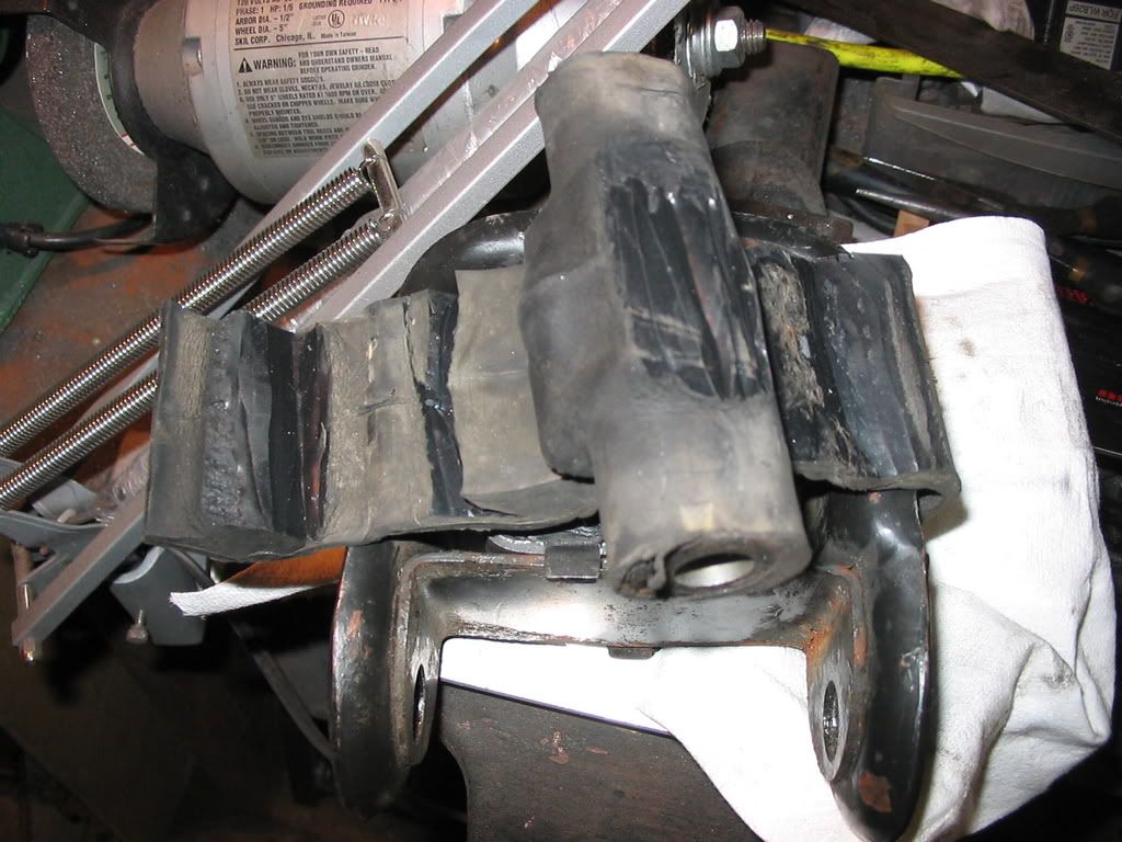

you can see how i cut up the OE mount and wedged all the additional rubber into the mount.
Write-Up: Filled Rear Motor/Transmission Mount RubberreusedfromOEmount
since we have the 4t80e that the Riv's getting we figured we'd at least try these out for how much the whipple could twist the old mounts lol
these shouldnt rattle the riv with the IS4 cam etc but they sure as hell wont move under load like the OE's did!
i have more pics but i havent uploaded em yet...the rear mount is a work of art lol
