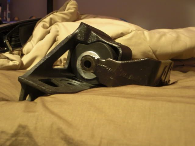

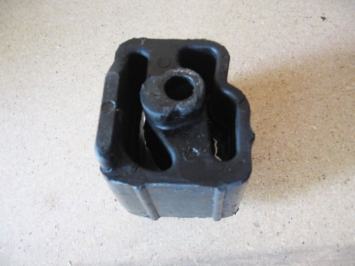

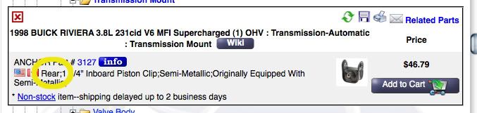

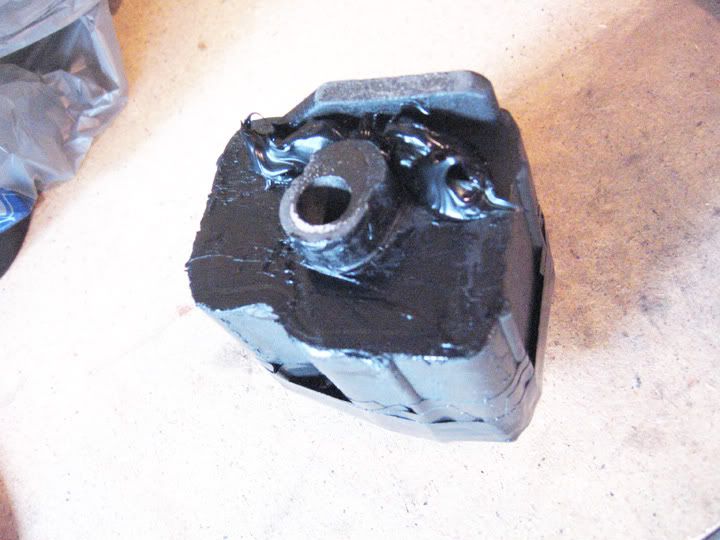

Eldo wrote:
That photo isn't our actual rear mount, is it Robo?
Also, I find it interesting that for the '97s RockAuto lists the 3127 front mount (with of course no rear mount.) The PA lists the 3065 rear and
a 3126 for the front mount, both N/A and S/C. I shouldn't have thought that, in a completely different chassis, they could match the rear
mount but not the simpler front mount... scratch

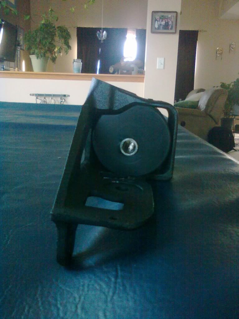

no. not our mount. its a "pour" kit for any mount. it fills the voids.I plan to use it on a custom mount im making. its alot cheaper than the stuff everyone else is using. and the same stuff Energy Suspension uses in their mounts.

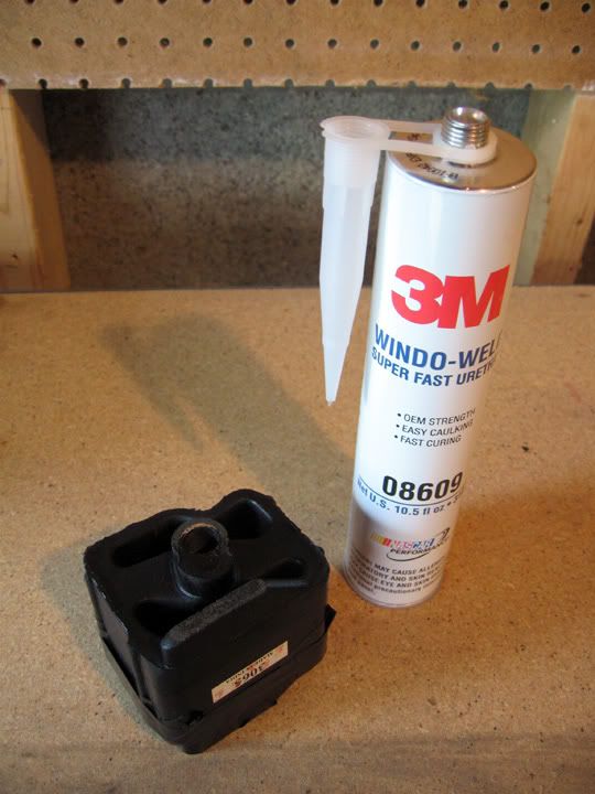

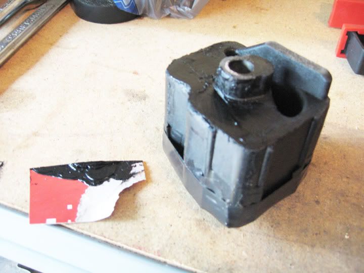

How long does the 3M window weld take to set? I filled one side of mine today and was going to do the other side tomorrow. Can I do it sooner?
Write-Up: Filled Rear Motor/Transmission Mount - Page 5 Empty
PostSubject: Re: Write-Up: Filled Rear Motor/Transmission Mount   Write-Up: Filled Rear Motor/Transmission Mount - Page 5 EmptySun May 01, 2011 3:07 pm
When i first did my front mount i filled the whole thing and let it sit overnight. it ended up breaking apart and squirting out the sides.
The second time i let it sit for 3-4 day and it is still holding shape.
My advice would be to let it cure as long as you can afford to have the car down. If you do put it in sooner than say 48hrs dont go WOT for another 24hrs.

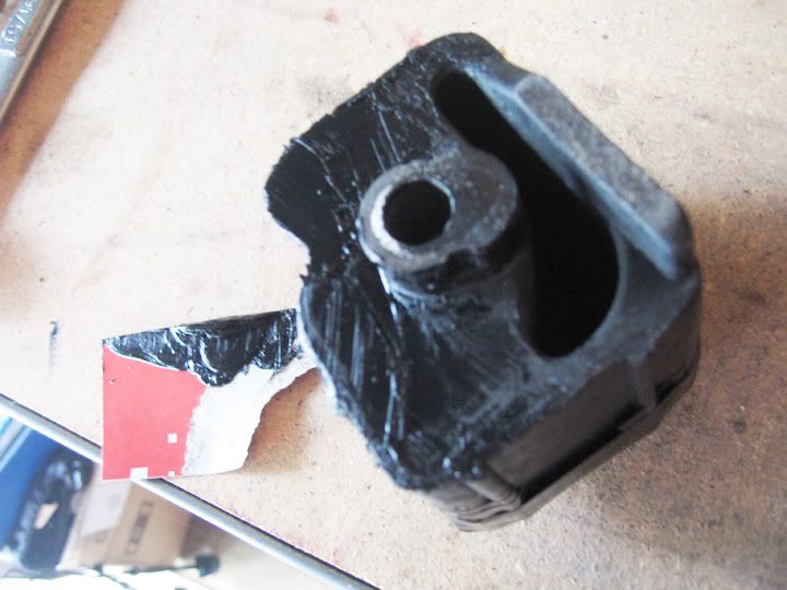

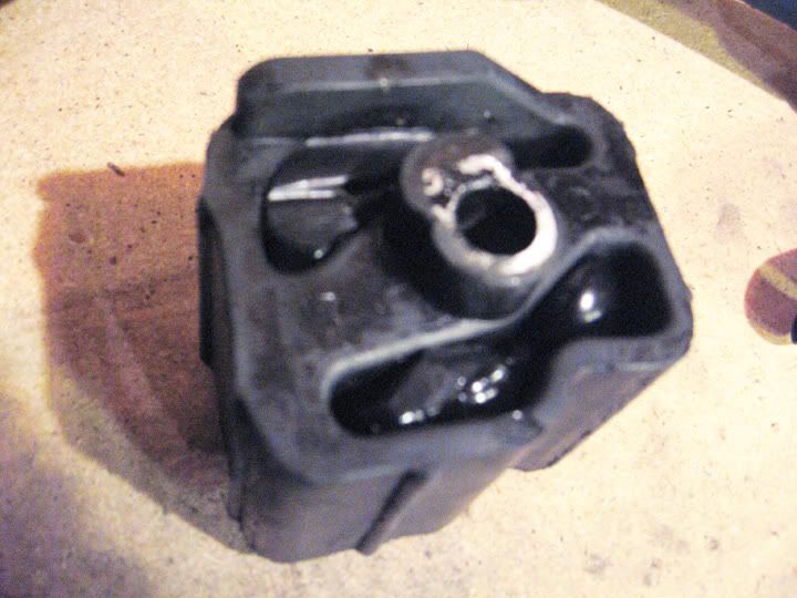

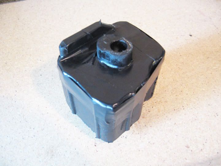

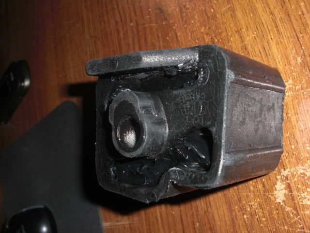

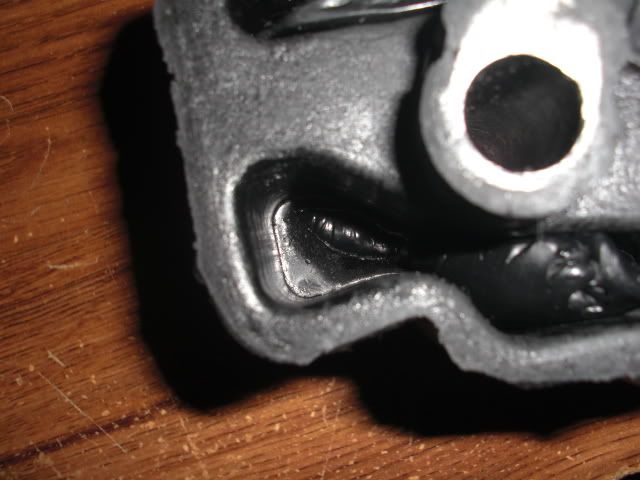

So the Plexiglas mold thing almost worked but not 100%
Write-Up: Filled Rear Motor/Transmission Mount - Page 5 CIMG3281
filling side
Write-Up: Filled Rear Motor/Transmission Mount - Page 5 CIMG3282
sealed side
Write-Up: Filled Rear Motor/Transmission Mount - Page 5 CIMG3283
That's the 2nd problem right there. The original rubber mold had a very thin barrier that appears to have become a tough barrier.
The first problem is I should have cut the tip off more for a larger opening and remembered to heat the stuff up a bit like Scott said. I was really breaking my hand to get it that far. I think had I addressed those two issue, this would have worked fine. I didn't have any leaking problems and otherwise, it looks like a good fill.
I guess the only thing to do now is prime it and spread the rest by hand.

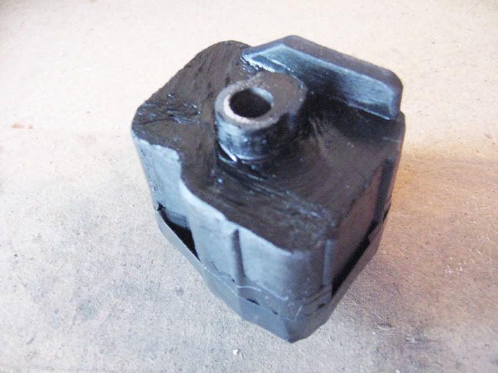

Mine sneaked up over time. I run a firmer shifting tune, so expected my shifts to be harder than stock. I didn't suspect the mounts were bad from feel of the shifts alone, but I knew the mounts were old and soft, and the engine makes a lot of torque. The mechanic spotted it right way with the car on the lift.
After replacing F/R mounts, I was surprised at how much more connected and solid the car feels - the "smoothness" you feel from our Buick 3800 has much to do with it's mushy mounts - it's isolation that creates some sense of that smoothness. The engine (mine anyway) isn't so smooth at idle like you might expect from a V-8 or V-12.
During acceleration, the applied torque sort of pins the engine in place and the ride and response is much less sloppy now. It's smooth torque delivery, and a really noticeable difference. And I do consider how my choice of having firm shifts and 20% more power likely contributed to wearing of the mounts!

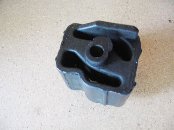

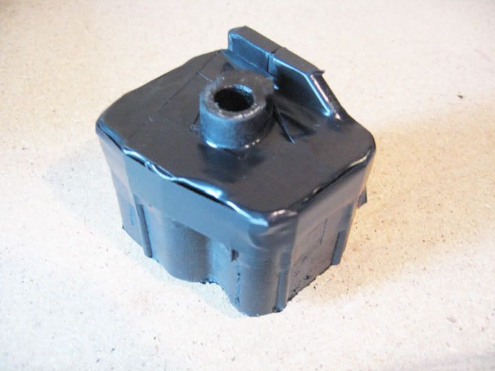

Here's the Anchor mount (made in India) I bought from Rockauto for around $30:
Write-Up: Filled Rear Motor/Transmission Mount - Page 5 IMG_0089
Write-Up: Filled Rear Motor/Transmission Mount - Page 5 IMG_0091

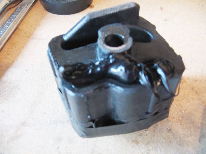

I taped up the bottom side to stop any leaks:
Write-Up: Filled Rear Motor/Transmission Mount - Page 5 IMG_0092
Write-Up: Filled Rear Motor/Transmission Mount - Page 5 IMG_0093
Here's one showing the flash inside at the halfway point:
Write-Up: Filled Rear Motor/Transmission Mount - Page 5 IMG_0094
Write-Up: Filled Rear Motor/Transmission Mount - Page 5 IMG_0095
Filling half on one side at 1:20pm:
Write-Up: Filled Rear Motor/Transmission Mount - Page 5 IMG_0097
Removing excess material:
Write-Up: Filled Rear Motor/Transmission Mount - Page 5 IMG_0098
Write-Up: Filled Rear Motor/Transmission Mount - Page 5 IMG_0099
Filling the other side, finished 20 min later:
Write-Up: Filled Rear Motor/Transmission Mount - Page 5 IMG_0101
Write-Up: Filled Rear Motor/Transmission Mount - Page 5 IMG_0103

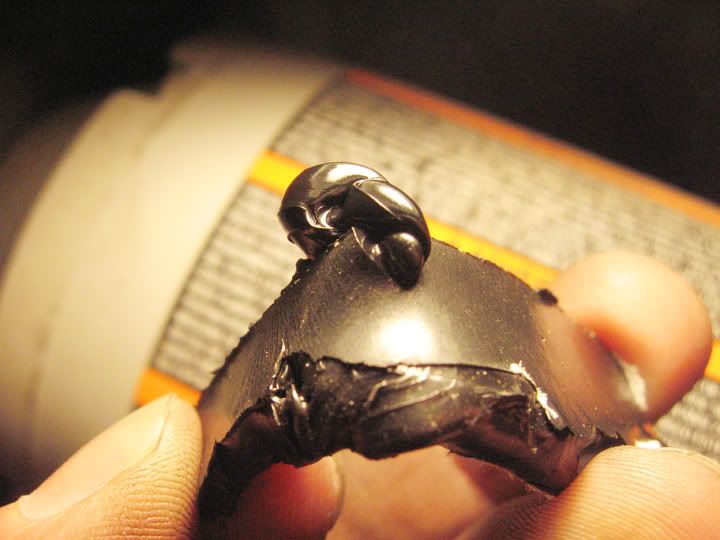

Here's a piece of excess weld, seemingly hardened, I found on the table later that night, 9:00pm. I sliced it to find it was not cured inside. It takes DAYS for this stuff to set:
Write-Up: Filled Rear Motor/Transmission Mount - Page 5 IMG_0107
Four days later, I removed the tape from bottom and filled the other half:
Write-Up: Filled Rear Motor/Transmission Mount - Page 5 IMG_0108

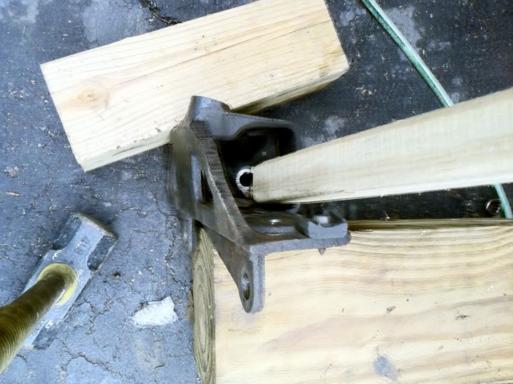

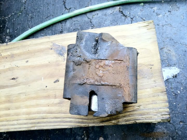

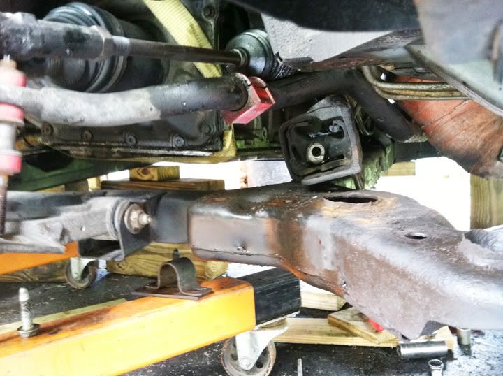

Extracting the old mount:
Write-Up: Filled Rear Motor/Transmission Mount - Page 5 IMG_0582
Write-Up: Filled Rear Motor/Transmission Mount - Page 5 IMG_0586
Write-Up: Filled Rear Motor/Transmission Mount - Page 5 IMG_0588
Extreme wear!
Write-Up: Filled Rear Motor/Transmission Mount - Page 5 IMG_0590
Press the new mount in to start it:
Write-Up: Filled Rear Motor/Transmission Mount - Page 5 IMG_0594
Tap in the rest:
Write-Up: Filled Rear Motor/Transmission Mount - Page 5 IMG_0598

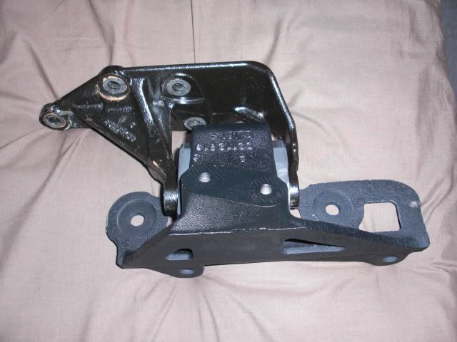

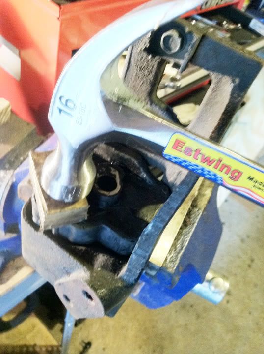

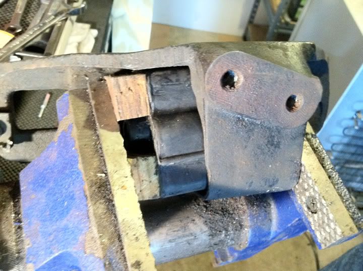

Ok here's my rear mount
Write-Up: Filled Rear Motor/Transmission Mount - Page 5 Image0825
Pressing in the pucks was a little trickier with this one but doable with pictured contraption.
Write-Up: Filled Rear Motor/Transmission Mount - Page 5 Image0827
Write-Up: Filled Rear Motor/Transmission Mount - Page 5 Image0826
Write-Up: Filled Rear Motor/Transmission Mount - Page 5 Image0828

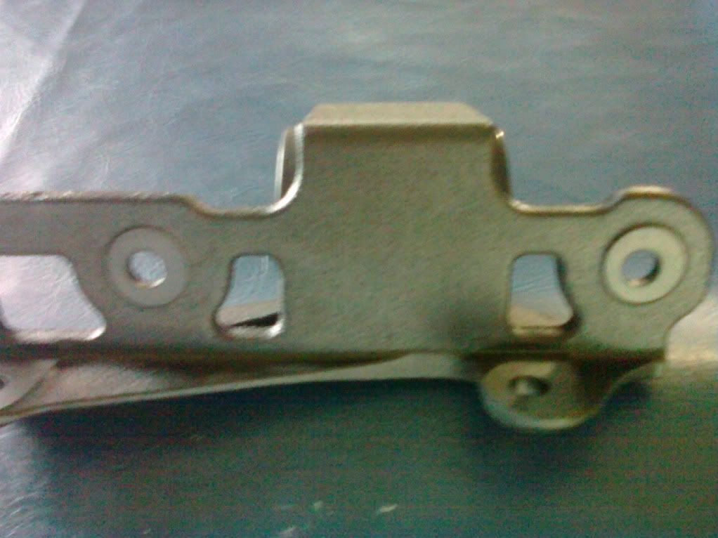

This won't even need the teflon tube, just a decently thick washer on each side. Hopefully it's lined up pretty good. I went a hair over a 1/4" lower than where the OEM hole is unloaded to account for the sagging under weight, which seems to increase with wear & tear. The last thing I want it to have this harder mount holding the trans up higher than the OEM one does and taking away my hood clearance.
The pucks' diameter is just a tiny bit short of filling the side-to-side space in the bracket but actually once you press it in, the pucks distort a little bit and it's about perfect. For that reason, a tighter fit top-to-bottom is better (forces the sides out more to take up the space there)

Write-Up: Filled Rear Motor/Transmission Mount - Page 5 Image0830
One washer on each side takes up the space on the rear - shouldn't need anything more. Still need to get back to you for the fronts.

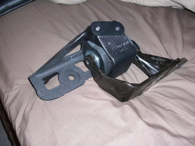

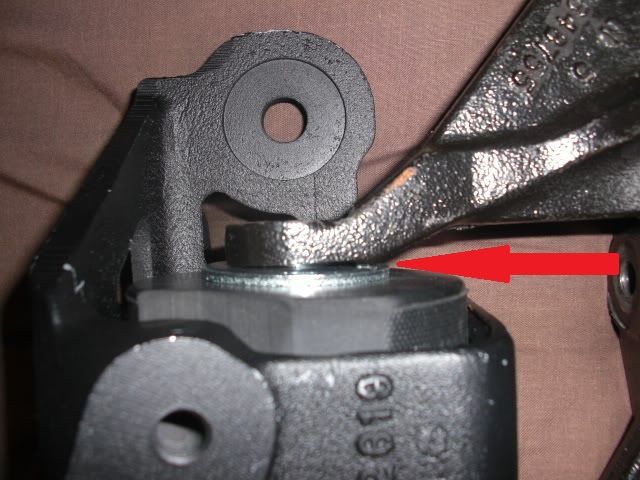

Write-Up: Filled Rear Motor/Transmission Mount - Page 5 CIMG3455
Write-Up: Filled Rear Motor/Transmission Mount - Page 5 CIMG3458
Write-Up: Filled Rear Motor/Transmission Mount - Page 5 CIMG3461
Write-Up: Filled Rear Motor/Transmission Mount - Page 5 CIMG3459ed
The pipe length and washers were dead on perfect - tight but not difficult.
That only thing that needs to be addressed using these large diameter washers right up against the bracket is the area that I have a red arrow pointing to. The casting flash line sticks out just a little bit into the area that the washer sits against on that one side. I don't think it's going to ruin anything but I will be grinding my bracket down to be perfectly flat between the trans bracket and the washer.
just FYI, that rear trans bracket is 95-98 rivs. The 99 is totally different.

You're right, Codith, that's the front mount. The listing at Rockauto says "rear", but the number 3127 is for a front mount according to Anchor Industries: http://www.showmetheparts.com/anchor/#
Write-Up: Filled Rear Motor/Transmission Mount - Page 5 ReartransMNT
It shows correctly as the front mount now.

I saw albertj recommends using a primer before using the window weld. Can you find it at Autozone with the window weld or can you find it elsewhere? Is this what everyone else used or did you just scuff up the rubber before you added the window weld?
