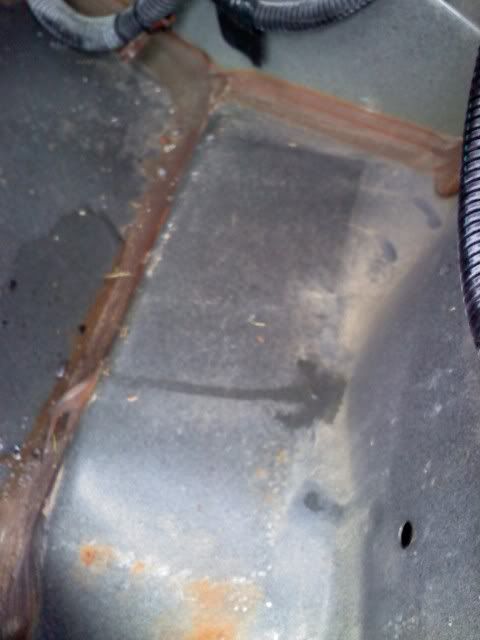

I have water on the underside of those seams, and on the topside at the seams. And on top of the carpet directly under the seams. Nowhere else is there water. I'm quite certain I'd find some signs of water on or near the weatherstrip material if that were the source. At any rate, I'll find out this summer when I first address the seams. They are not in good shape either, the material is quite deteriorated.

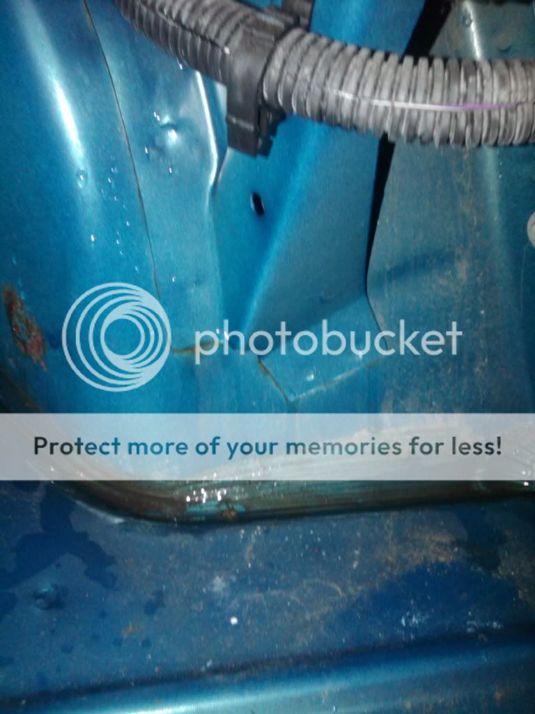

I am relatively sure its not the trunk lid seal, after a rainy drive into work today I looked in the trunk and the inside of the lid and the inside weather stripping were dry. I did have water coming in again. It looks like its running down the inside of these supports:
Both sides are wet there, and you can see a little water running away from the seam at the bottom of the wheel well there. I am guessing its coming in somewhere where the quarter panels meet (where that sort of gully is by the C pillar), but not sure. Going to have to get locked in my trunk to see.
When the carper was in there, it was wet on the left and right sides between the well and the quarter panel walls, no where else.

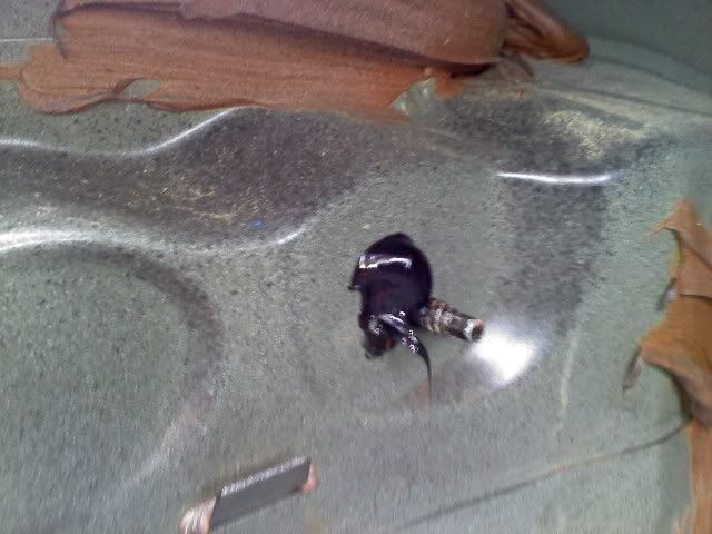

I made some progress over the weekend. I found the majority of the water was coming through a seam behind the tail light in the passenger side. That video did help, as did having someone lock me in the trunk. The other minor leak is coming in around the vent on the passenger side. Its not from the vent itself, but coming in around the outside where it mounts to the body. I soo no way to get to this thing from the ouside. It doesnt leak much at all, but if you push on it, water comes out of the foam seal. Anyone know how to get to this thing? Thanks for your help everyone, my trunk is almost safe!
And heres a video of the leak

I remember seeing that vent when my bumper was off, it looked like that was the only way to service it, how about just sealing around it on the inside?
Post Count : 6922
Merit : 133
PostSubject: Re: Trunk Leaks   Mon Mar 08, 2010 8:49 am
OK I get it.
Use a wet-dry vac set up as a blower, thru a nozzle (cone concentrator or "car" or "crevice" tool) to blow the seam dry (blow thru it) then seal with seam sealer. See this:
http://www.3m.com/Product/information/Automotive-Joint-Seam-Sealer.html
and/or this:
http://www.tptools.com/p/1812,233_Auto-Body-Seam-Sealer.html
Should be available locally at a CarQuest or NAPA - or their counterperson will know where to get it from. Never seen it at Autozone. Basically you put it on then force it into the seams with a putty knife - they lay a bead over the seam and smooth it with your finger (wearing rubber goves) or a popsicle stick, or the nozzle of the caulk cartridge of you get that instead of the can. Forcing it into the seam gets you out of pulling the bumper cover. Of course you could pull the bumper cover (it is not that hard) and seal it from that side, whcih might be preferred because then you can also clean off dirt and fix rust (if indeed there is any of either).

I was thinking of doing it like that from the inside, looks like a real PITA to get from the outisde. Thanks!

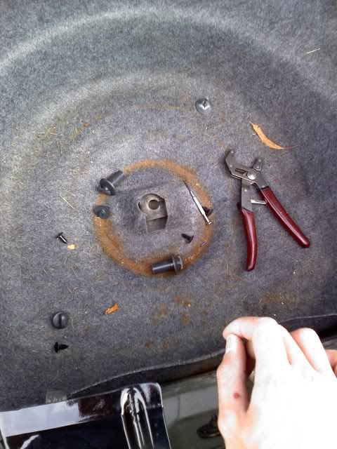

for the past few months i have noticed that my trunk has had a leak and ive been waiting for a good day to look for it. that day was today lol.

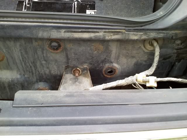

well, after some testing with a hose and some water i concluded that the bolts on the back of the tail light that lead into the trunk were letting water in!!
it looks like the gaskets at the ends of them were starting to rust off
damage it cause - little water marks here and there but the carpet was SOAKED whenever it rained.
water running down the side from my scientific testing lol
the holes that the taillight goes into
