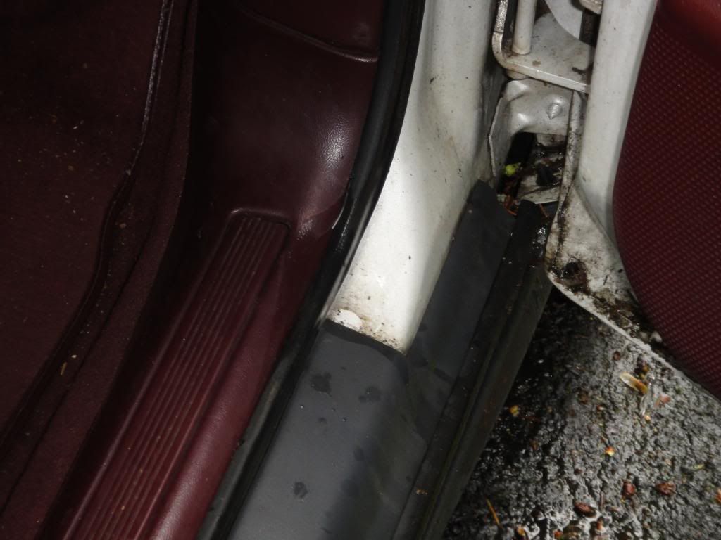

It's still raining here and I grabbed a crappy cell pic on my way to work, but I think it shows what I am trying to describe. You can see in the second picture that it is wet between the plastic sill cover and the gasket. The drops you see on the sill cover are because it was raining so damn hard when I tried to take these pictures.

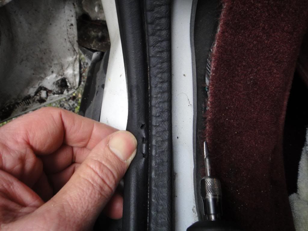

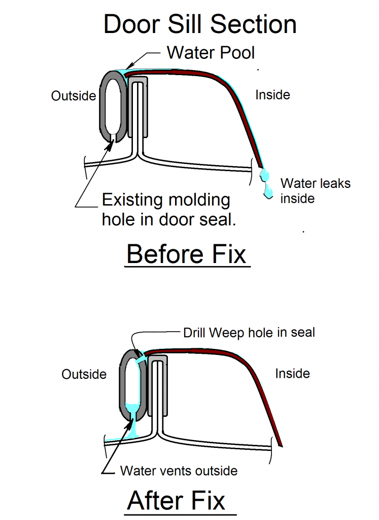

PostSubject: Solved my floorboard leak problem -    FAQ: Wet Carpet - Interior Leak Problems - Page 4 EmptyTue Oct 01, 2013 11:59 pm
I think I've solved this problem. With wet weather on its way in the fall and winter I think this is a good time to address this problem which has been vexing me for some time.
I'm satisfied the cowl drains and A/C condensate drains are not at fault here since I've checked them both along with the moonroof drains.
The problem shows up when the car is parked on a street with a significant crown to it so the car is not parked level (at least in my case).
Some water leaks past the door seal along the front edge and pools in the forward "crook" of the door opening.  Like this:
FAQ: Wet Carpet - Interior Leak Problems - Page 4 Water_Ingress_zps5765fae9
And as shown here on the passenger side:
FAQ: Wet Carpet - Interior Leak Problems - Page 4 Proof01_zpse4281de7
If the crown of the road tilts the car towards the driver then the water will enter the passenger compartment.  If toward the passenger's side then it enters the driver's side floorboard.  If the car is parked uphill with a tilt toward the passenger side then the water will collect in the rear, driver's side passenger floorboard, etc...
The solution was to drill a few holes in the door seal at the point of water collection so the water could drain to the outside of the sill as shown in the following diagram:
FAQ: Wet Carpet - Interior Leak Problems - Page 4 SealSection_zps931454f1
Here's a picture of the actual (3) holes I drilled with a carbide bit in a Dremel tool.  I drilled 3 holes so that air could enter the hollow seal and counteract any tendency of capillary action or surface tension preventing the water from draining into and out of the seal.
FAQ: Wet Carpet - Interior Leak Problems - Page 4 WeepHoleFix_zps4f2ad1ea
I tested this afterwards and found that it drains very well and I've had no problems since. I only modified the driver's front corner of the door openings but should really do all four corners of the doors openings.
In my case, there was an existing molding hole in the bottom of the door seal exactly at the lowest point of the seal where it needed to be.  Creating the lower weep hole in the seal would have to be done if it didn't already exist. For instance, the driver's rear corner of the door opening on my car I don't believe has a molding hole already in place.  I'd have to create it.
This seems to be a problem that could affect a lot of Riv's since it's a result of the basic design of the door seal.  If anyone doesn't have this problem I wouldn't know why not.
It's been raining pretty hard here the last few days and I've had no leaks.  I hope this helps someone else who may have this vexing problem.  I discovered this by chance when I saw the rivulets of water that had run over the surface of the carpet.
